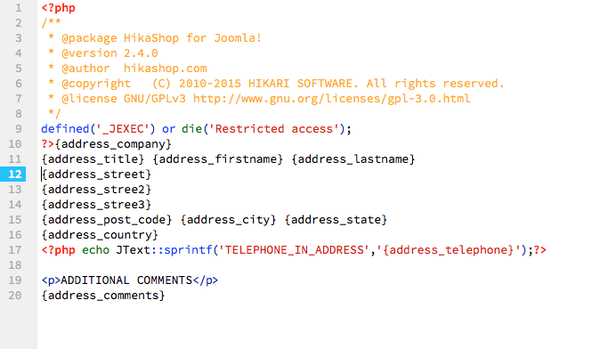

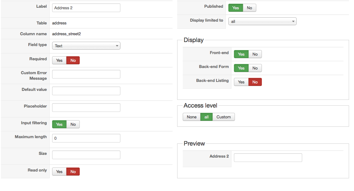

  • Posts: 100
11 years 4 months ago #197043
I have attached a screenshot of the address_template.php view file (incidentally I also made the exact modifications to the address_template.php file in the admin folder).
Also please find attached a screenshot of the configuration options on one of the custom fields. By the way, this replicates the configuration of the other custom fields, and also the core fields.

11 years 4 months ago #197093
In the address_template views, the "t" is missing for the address_street2 and address_street3.
So the issues seems to come from that.

11 years 4 months ago #197343
Please be sure that you are overriding the view for the right front-end template.
To test if you are editing the right view, you can add some "raw text" (text without brackets) in order to see if the text is display afterwards in the invoice ; then you will be able to set the tags you want and the order you want.

  • Posts: 86080
  • Thank you received: 14186
11 years 4 months ago #197471
I don't see any other reason.
Either you're not editing the correct view file or you're not using the correct column name inside the curly brackets.
Note that there are two address_template view file. One for your frontend template and one for your backend template. The column names need to be corrected for both view files.
The tags will be removed automatically if there is no custom address field corresponding to the tag.
