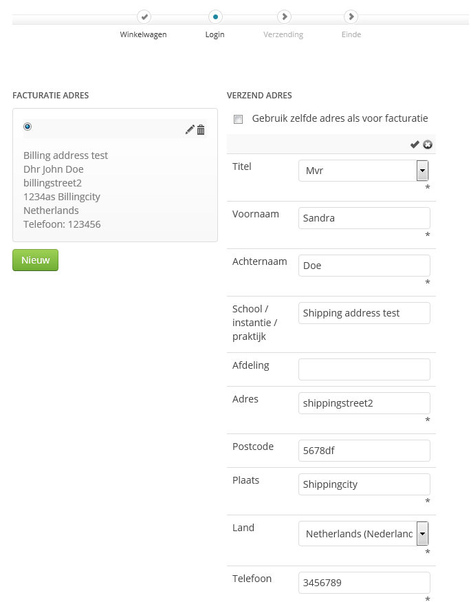

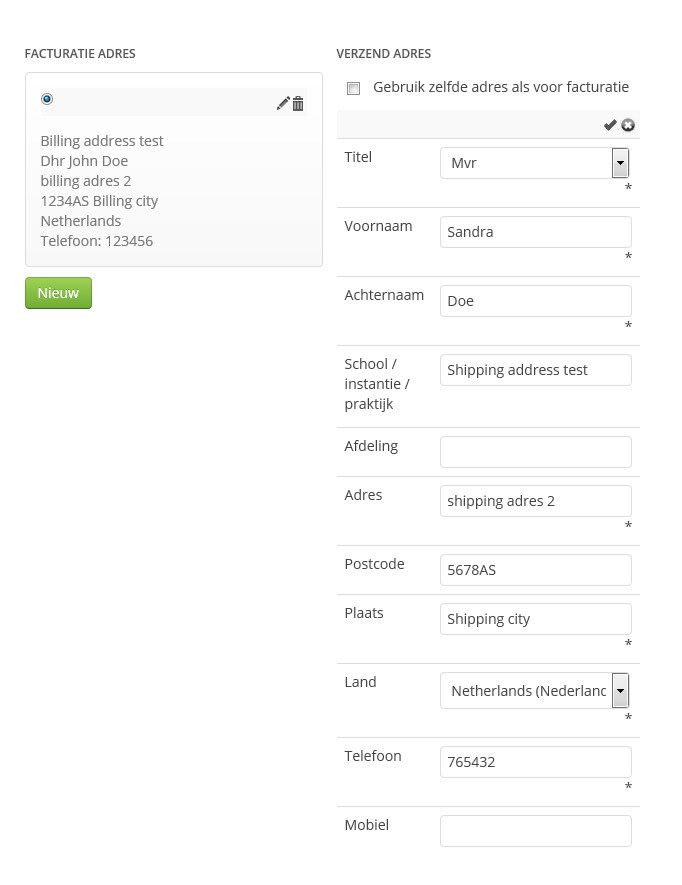

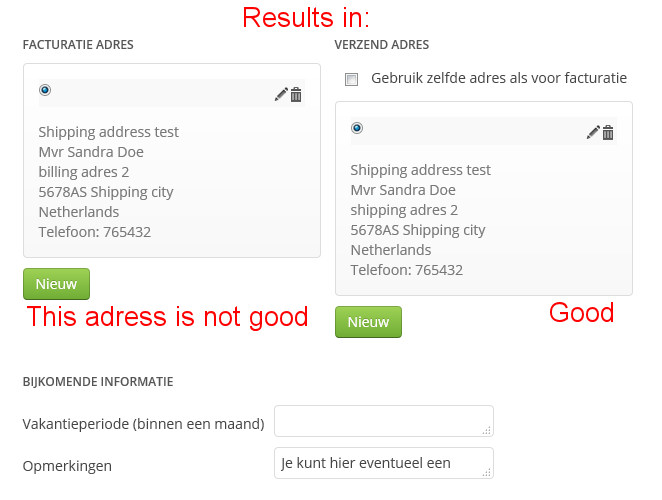

Hello Xavier,
I have tested it now, to be sure. This is the result:
As customer I give a billing address and a different shipping address. And yes, I have choice in different shipping methods.
After fill in the shipping address, I push the button V (the OK sign - in right top) for saving the adress.
After that, the shipping adress has overwrite the billing address ?! shipping address => billing address
This seems a bug, I think.
I have no possibilitie to give 2 different adresses. See also the screenshots (before and after pushing the OK-button)

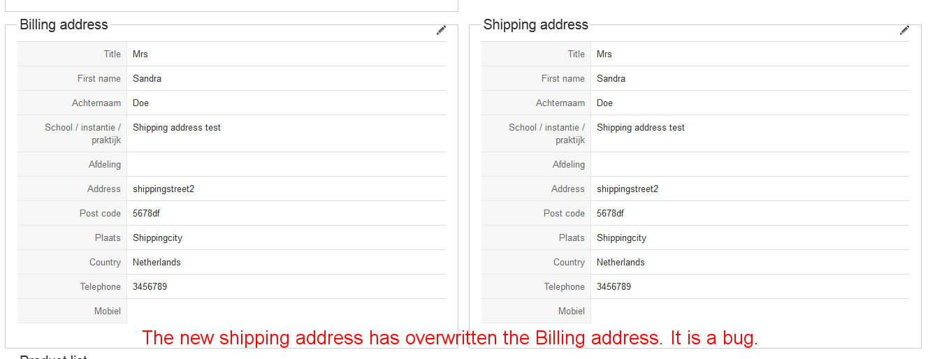

11 years 4 months ago #197693
Hi Xavier,
I have tested again: first I installed new Hikashop version (com_hikashop_business_v2.4.0_2015-04-08_10-33-34.zip)
Then I ordered a product with a different Shipping Address. This time, after giving 'shipping address' I did not push the OK button (right top) but push the 'next' button (order).
The result: as customer I get an e-mail with Billing and Shipping address, both are the same (that is not OK)
In Hikashop I checked the order: shippings address details are placed in the Billing address.
See screen pictures.
So it is a bug.

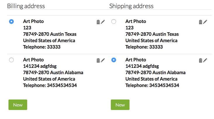

  • Posts: 112
11 years 1 month ago #206458
I am having the exact same problem and I do not use the SH404SEF extension. The "solution" appletree found may only be a partial solution. For me, when I select the "Dropdown List" option for the shipping address, the shipping address is saved correctly and does not change the billing address. But, the other two options cause the billing address to change to the new shipping address. It appears that HikaShop is forcing the billing and shipping address to be the same.
So, I am currently using the Dropdown List which would normally be fine except it shows the option of choosing the old address and the new address. This complicates the checkout process. If a customer changes the shipping address, I would much prefer that only the single updated shipping address show under the shipping column. Not two optional address. The attachment shows the 4 addresses in the checkout.
