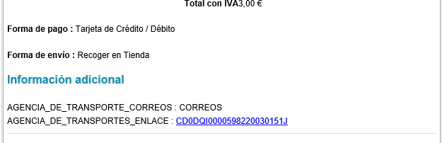

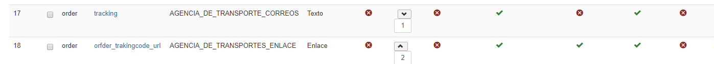

6 years 8 months ago #308924
I have created two custom fields and assigned a label to it, in the value. They are inside additional information in the order.
But when receiving the emails the value of the label is not shown, if not the name, how it could be solved. I attach images.

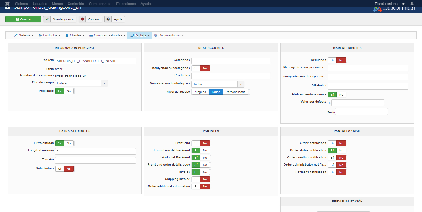

  • Posts: 85393
  • Thank you received: 13956
6 years 8 months ago #308935
I'm sorry but I don't understand your question.
On your custom fields listing screenshot I see the exact same name as on the email.
So it looks like it's working for me ? Or maybe we're talking about something else ?
Could you tell us more about the situation ? What did you expect to see ?
Could you provide a screenshot of the settings of the custom fields and not just the listing information ?

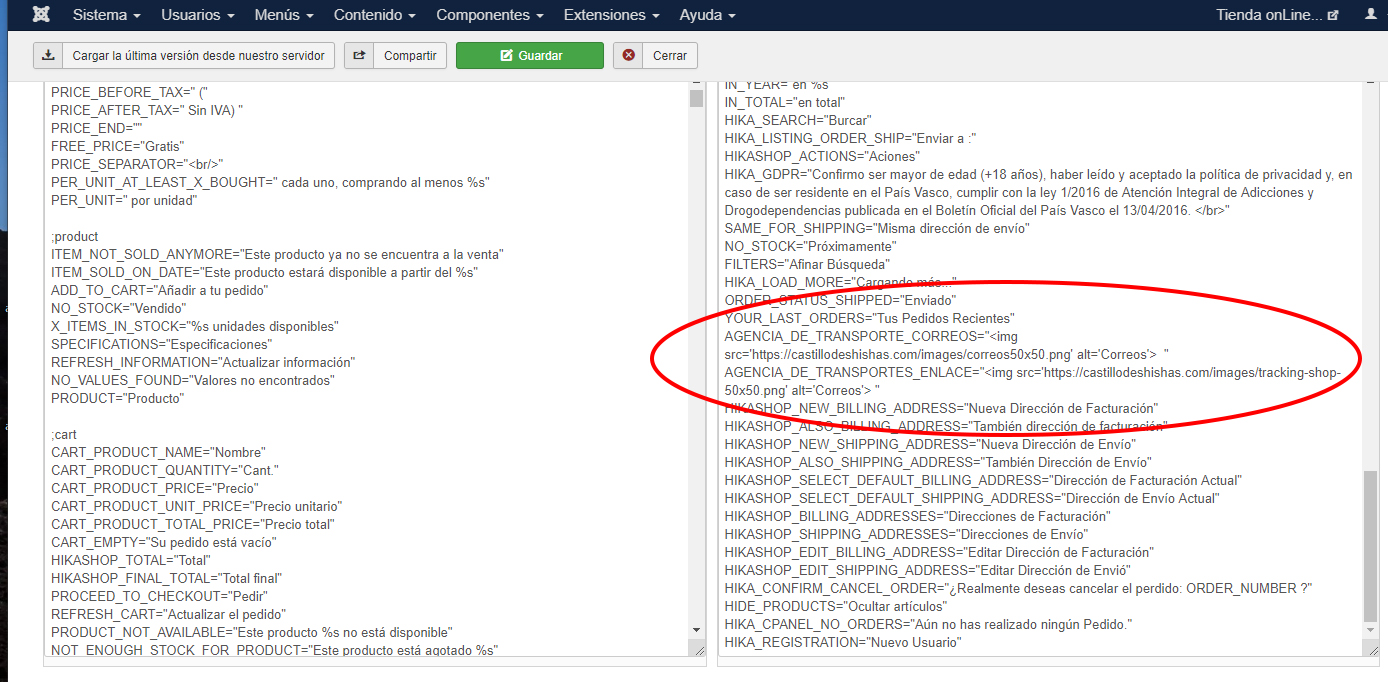

  • Posts: 267
  • Thank you received: 5
6 years 8 months ago #308938
Hello Nicolas and thanks for yor aswer.
It is a translation chain
  • Posts: 85393
6 years 8 months ago #308939
Note that in the backend, translation keys of custom fields with HTML tags are not replaced to avoid issues, such as not being able to click on the custom field edition link, etc.
So if the email was generated as a preview or by changing the status of the order manually in the backend, it's normal that the label of the custom field is not translated. However, if the email is sent after an automatic order status change, the email should have the label translated.
I suppose that you're in this exact situation.
If that's a problem for you, then you'll have to edit the email and in the preload version, you can change the line:
echo $sep . $fieldsClass->trans($oneExtraField->field_realname).' : '.$fieldsClass->show($oneExtraField, @$data->cart->$fieldName,'user_email');
to:
echo $sep . JText::_($oneExtraField->field_realname).' : '.$fieldsClass->show($oneExtraField, @$data->cart->$fieldName,'user_email');
