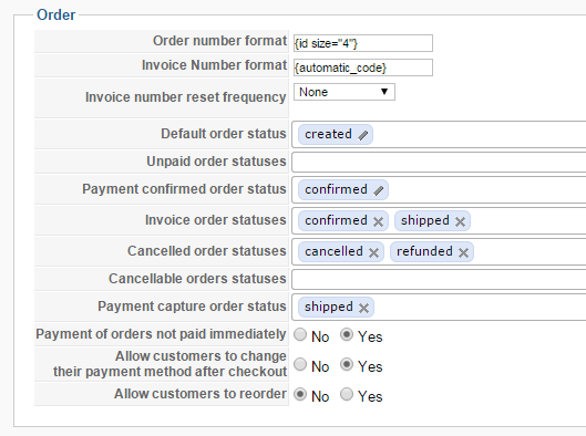

  • Posts: 15
11 years 2 months ago #203785
OK - Here is a shot of the Orders section of the configuration.
11 years 2 months ago #203796
Can you try it with the "Unpaid order statuses" option set to "Created" ?
The following user(s) said Thank You: gmarsh
  • Posts: 15
11 years 2 months ago #203846
Ah! Thank you very much! That took care of it. -Gary Marsh
