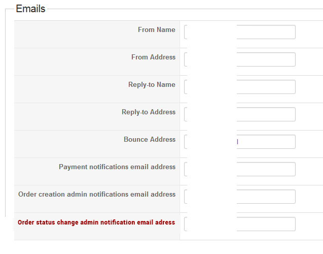

10 years 9 months ago #207046
Thanks that is an good alternative. But maby it's a good request for future releases.
See my image how it could look like in future release:
Thanks!
Kind regards,
Lumiga
  • Posts: 85441
  • Thank you received: 13965
10 years 9 months ago #207051
Our goal is instead to replace the payment notification email with an email with all the information about the order in it.
