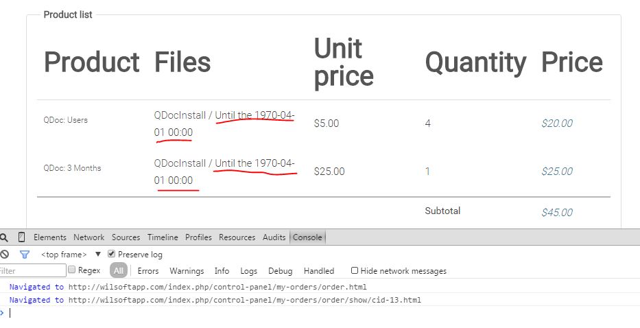

-- url of the page with the problem -- : wilsoftapp.com/index.php/control-panel/m...der/show/cid-13.html
-- Joomla version -- : 2.5.28
-- PHP version -- : 5.3.3
-- Browser(s) name and version -- : ie, chrome, firefox
-- Error-message(debug-mod must be tuned on) -- : Incorrect date in order/File
Could you help me to set up the correct date?
I want to see a normal or recent date, don´t care delete this line, in all orders see the same date in this place.

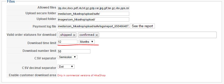

What have you configured for the download time limit ?
www.hikashop.com/support/support/documen...nfig.html#main_files

I change this parameter to days, hours, months and always have the same result, any other idea?
or how to remove this information?

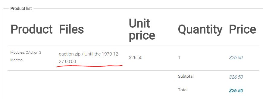

10 years 10 months ago #211181
So I guess that your order is not confirmed or you do not have any setting for the "invoice order statuses".
www.hikashop.com/support/support/documen...nfig.html#main_order
In that case you can configure HikaShop to generate the invoice number or you can apply that patch in the view "order | show".
$order_created = (empty($this->order->order_invoice_created) ? $this->order->order_created : $this->order->order_invoice_created);
if(!empty($this->download_time_limit))
	$fileHtml .= ' / ' . JText::sprintf('UNTIL_THE_DATE',hikashop_getDate($order_created + $this->download_time_limit));
