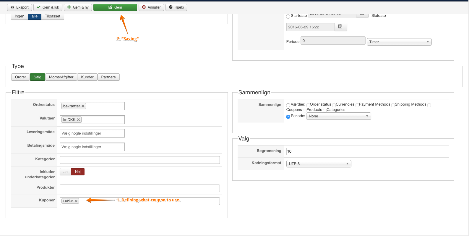

10 years 1 week ago #244346
Hi Jerome
Im in the same situation as topicowner.

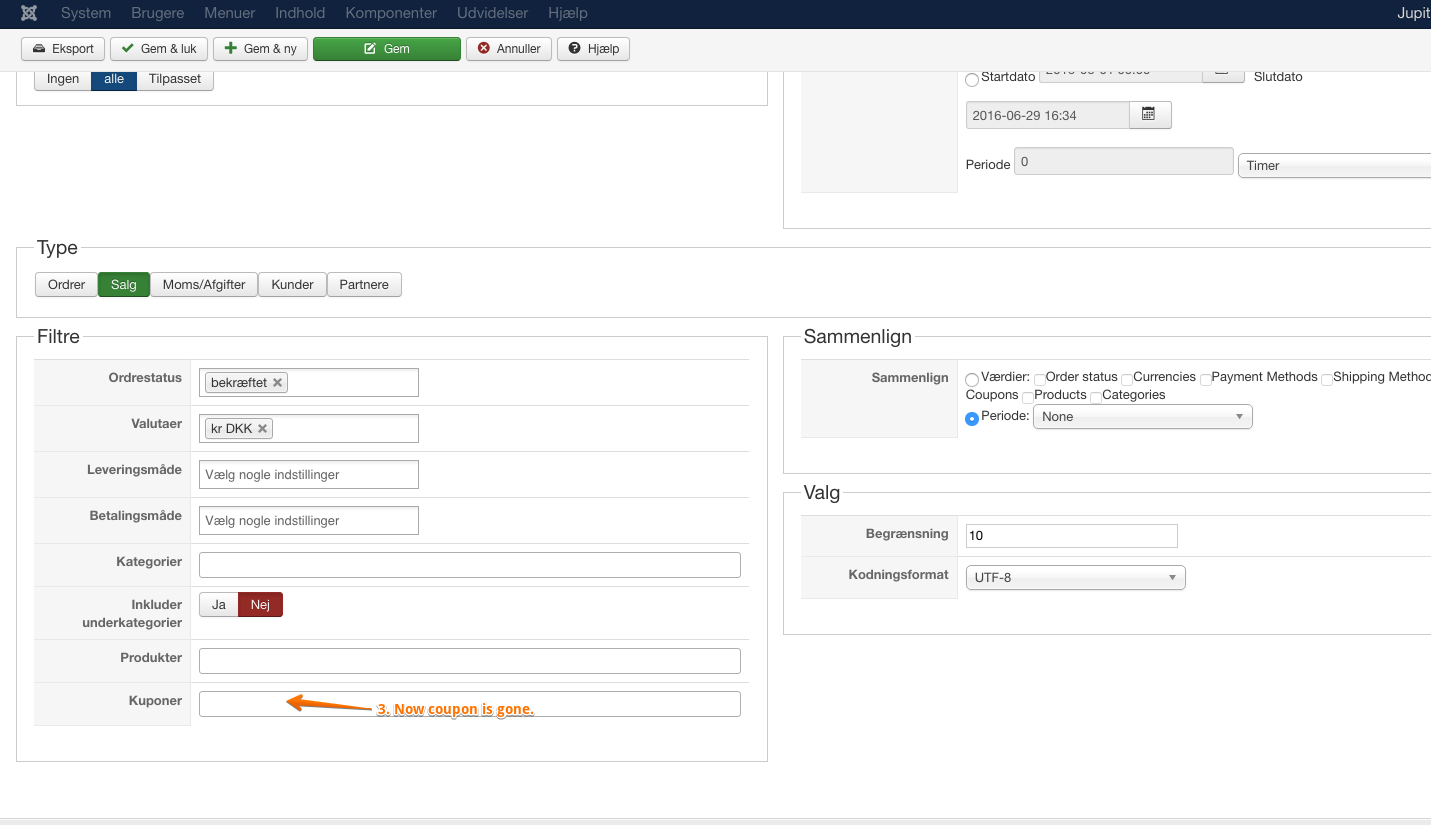

I want to see an overview of how many orders my "vip-customers" have done using their unique discount coupon.
But when im trying to setup a widget and then setting Coupon to my own - it will dissapear as soon im pressing "save".
Therefore i cannot get this statictic. Can you help me out?
The site is: jupitercykler.dk
I can get u Admin-login.
Ive added pictures.
Looking forward hearing from you.

10 years 1 week ago #244469
Change the line:
echo hikashop_getLayout('dashboard','widget',$params,$js);
to:
$couponslist = @$this->element->widget_params->coupons_list;
		$this->element->widget_params->coupons_list = $couponslist;
in the file administrator/components/com_hikashop/views/report/view.html.php and that should fix the problem.
