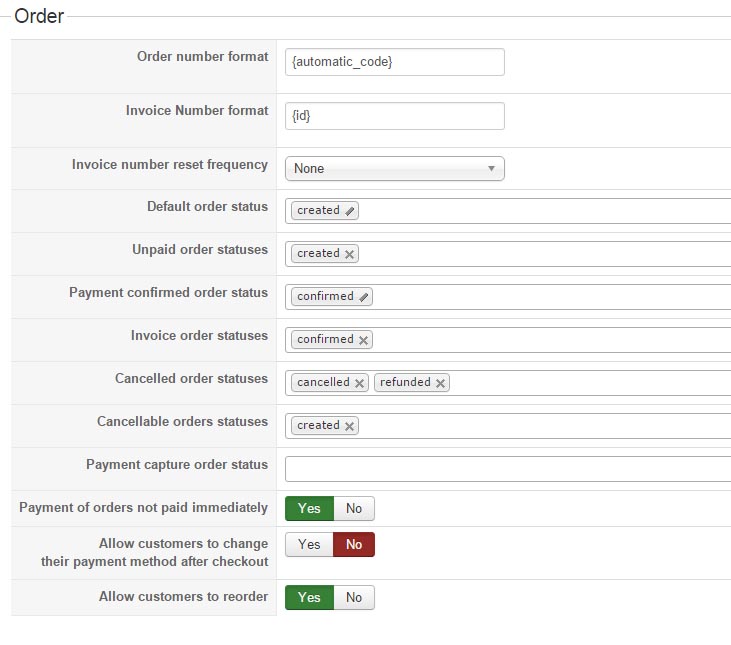

Everything working fine, then I just try to edit last order id on database table "hikashop_order" via phpmyadmin like "3435435764" to test the order id and invoice id.
After then it's generating strange order no like, A3A5A0A2A1A4A7A6A0A9AAAAAAAAAAAAAAAAAAAAAAAAAAAAAAAAAAAAAAAAAAAAAAAAAAAAAAAAAAAAAAAAAAAAAAAAAAAAAAAAAAAAAAAAAAAAAAAAAAAAAAAAAAAAAAAAAAAAAAAAAAAAAAAAAAAAAAAAAAAAAAAAAAAAAAAAAAAAAAAAAAAAAAAAAAAAAAAAAAAAAAAAAAAAAAAAAAAAAAAAAAAAAAAAAAAAAAAAAAAABARCTWWF
and order details also not showing if I click this order no.
Here attached current order configuration screenshot, unfortunately it's still in localhost.

Why would you edit an order ID - or anything else - in the database? Doing so directly in the database is - like changing other key values in the database directly - highly destructive. Since various database tables, fields and their values are related to each other, your change has destroyed the relationships for at least this order.
It should go without saying that manual interference with the database is highly risky, and indeed, in your case harmful.
Change the order number back, if you can, or restore a backup.

And what exactly did you do with the order_id or the invoice_id ?
Because the conversion of the order_id "3435435764" using the hikashop_base function is : "B3A4E3T5J4W3M5J764"
