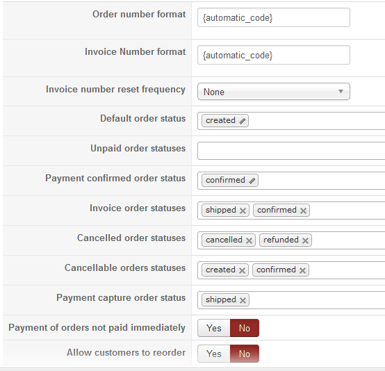

  • Posts: 8
10 years 11 months ago #214764
Hi Nicola
sorry for late response.
As I am using shop as "not registered" I do not see any orders listing in the frontend. (where from can system know which orders are mine if I am not registered - so also not logged in.
Below is screen from my orders settings. Do you have an idea how to move forward?
Thank you
Michal
  • Posts: 86080
  • Thank you received: 14186
10 years 11 months ago #214767
Create an order with the new button in the backend order listing and assign it to yourself.
Then, log on the frontend and access a menu item of the type hikashop order listing (that you would have created before via the Joomla menu manager) and there you'll see your order along with the cancel button.
Try to click on it and see if that works. Then, try the link in the notification email that you can send to the customer when you change the status of the order.
Based on what works and what doesn't, that should already narrow down the issue.
