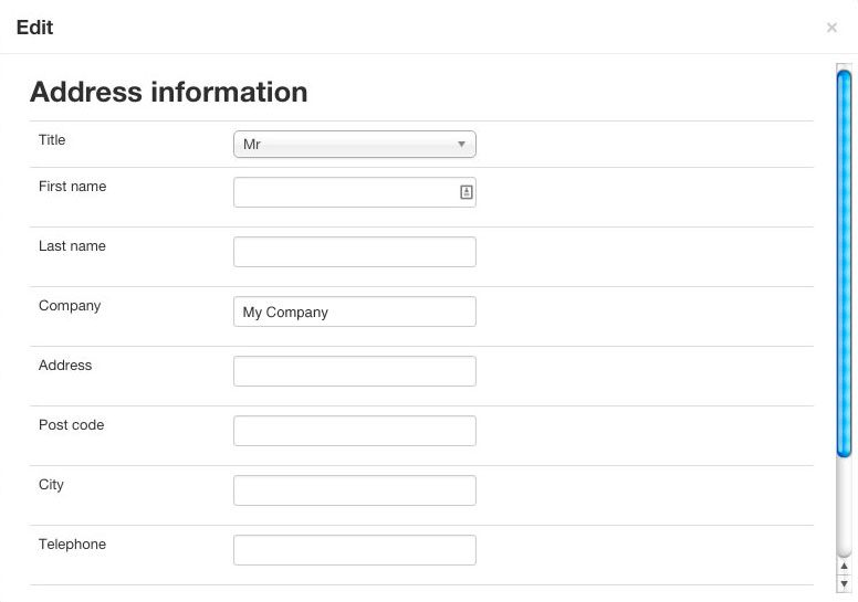

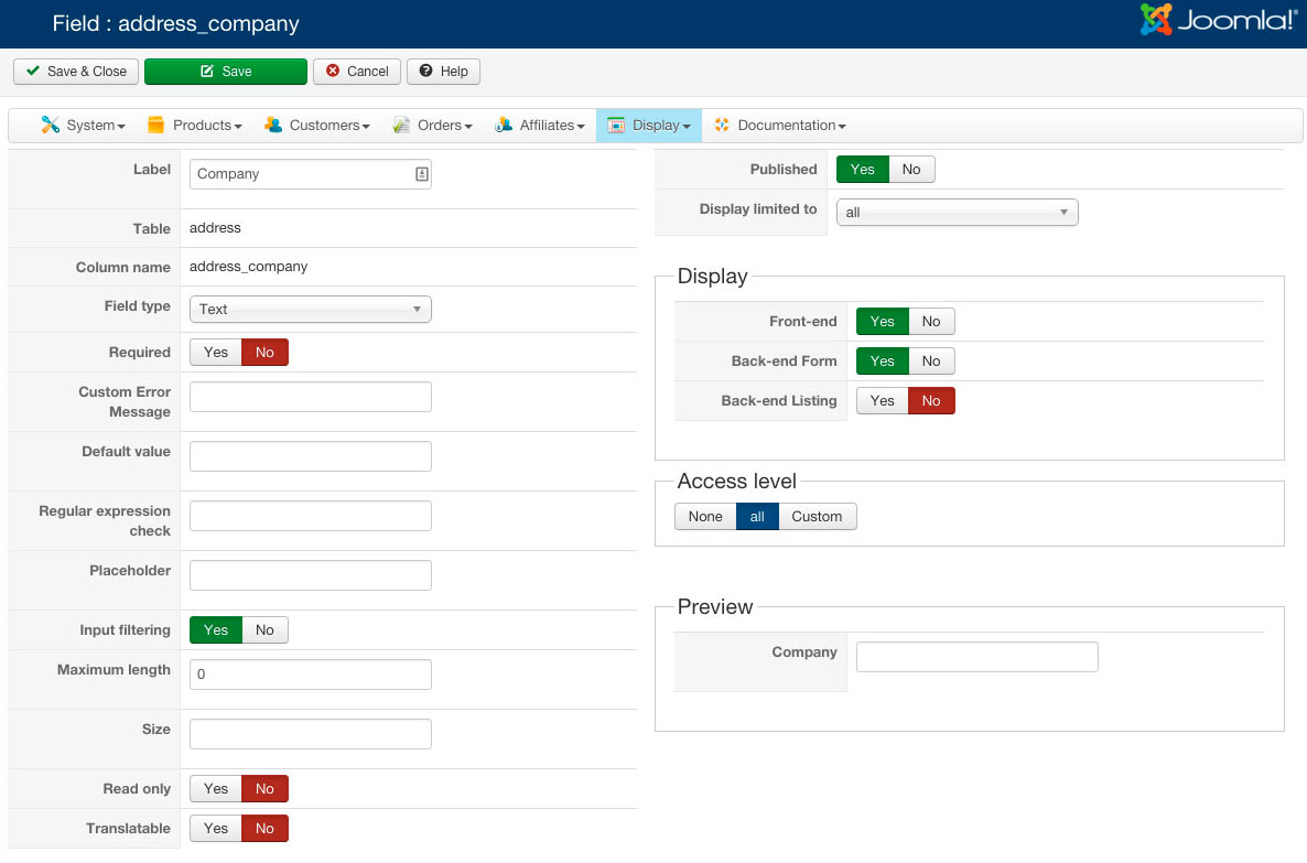

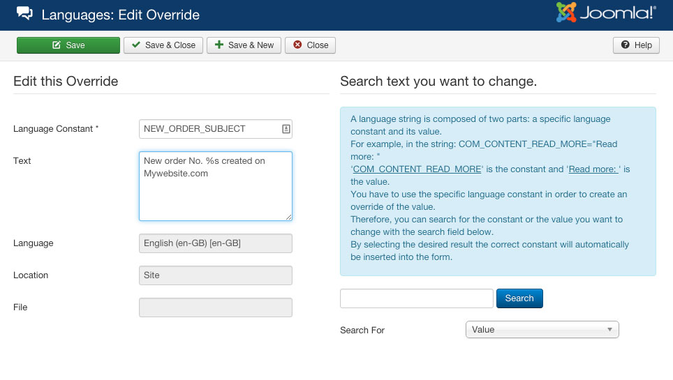

Is it possible the problem is somewhere else? I've attached screenshots of what I have in my "address_company" custom field, then that field filled in the User Address Information screen, and then my "NEW_ORDER_SUBJECT" language override. Hopefully this sheds some light on the issue. Thanks!
