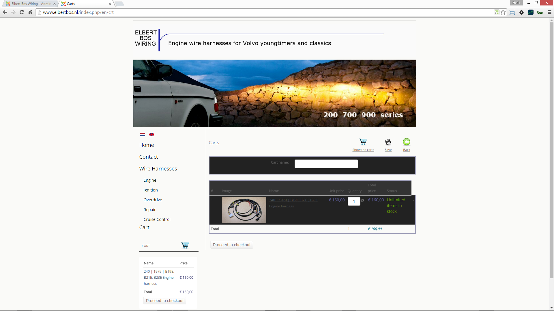

-- url of the page with the problem -- : www.elbertbos.nl
-- Joomla version -- : 3.4.4
-- PHP version -- : 5.4.41-1
As you can see in the screenshot the cart displays incorrect.
This is out of the box, I didn't write any CSS.
Any idea how to get it correct?

I apologize for not making clear what I meant. That is: why is the table row containing "image", " name" etc. shorter than the
other rows of the table?

10 years 10 months ago #216978
The problem doesn't ocur in the checkout. If a visitor clicks on the menu item "Cart" the display of the cart is wrong as mentioned above.

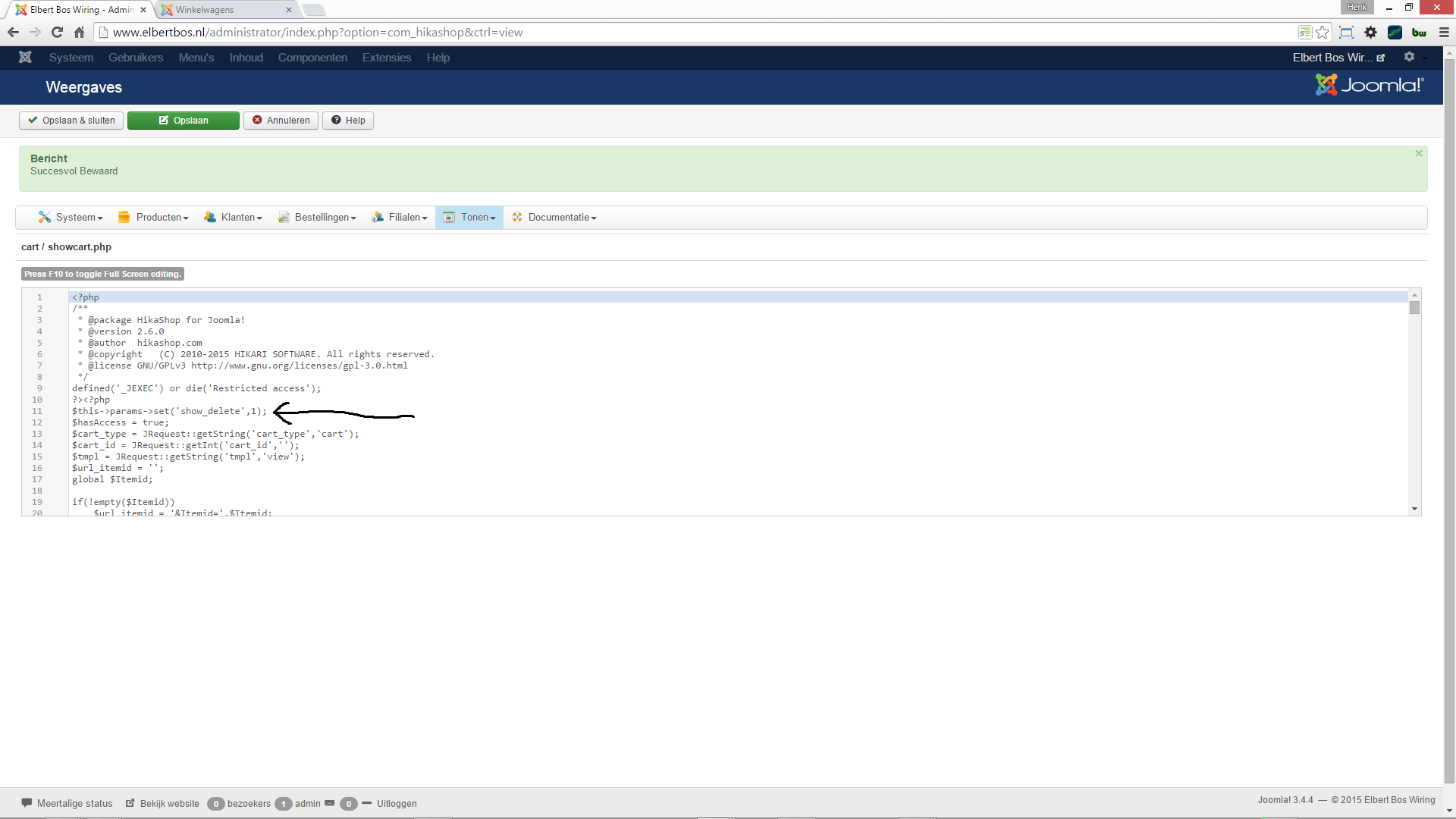

10 years 10 months ago #217159
You can add this line at the top of the view:
$this->params->set('show_delete',1)
  • Posts: 43
10 years 10 months ago #217246
I did, but the delete icon is still not displayed.

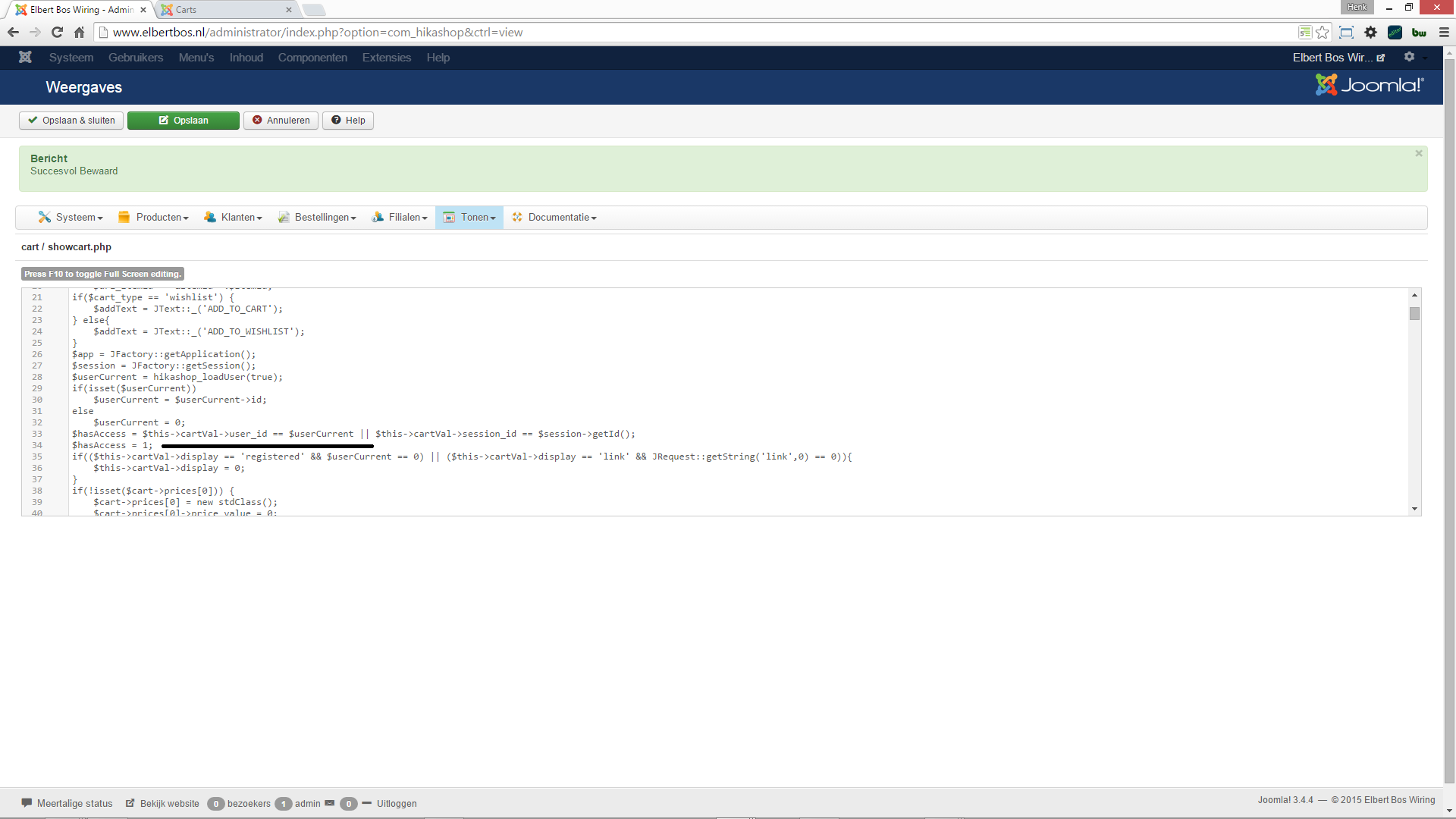

10 years 10 months ago #217249
When looking at the cart, are you using the correct user account for that cart ?
We have the code:
$hasAccess = $this->cartVal->user_id == $userCurrent || $this->cartVal->session_id == $session->getId();
Which check if the current logged in user is the one who own the cart. If not, so no delete button displayed.
So in your case, it is an issue due to the used account, maybe not the correct one, or a session_id issue.
If you try to add the code:
$hasAccess = true;
after the previous given code, is the delete button displayed ?

10 years 10 months ago #217311
No, I'm afraid not. In the screenshot you can see how I inserted the code. Perhaps I did something wrong?
10 years 10 months ago #217354
My bad, I forgot to say that the code $hasAccess = 1; must be added after that one:
