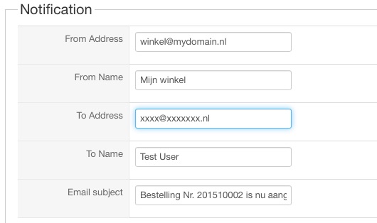

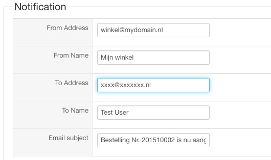

So after two days I get a message from my email server that the emails could not be delivered to address:
This email address is being protected from spambots. You need JavaScript enabled to view it. (where mydomain is my domain name).
So both the emails to the client and the emails to the shop admin are being sent it seems including the www in the email address.
Sending emails from AcyMailing works successfully. I don't have any problem emailing from within the Joomla system.
When sending an email from Hikahop notification system the address is correct as shown below (the email addresses have been censored in the interest of privacy). These email addresses are correct and do not include the www in the email address. It seems to be going wrong somewhere after this step. Any ideas??
