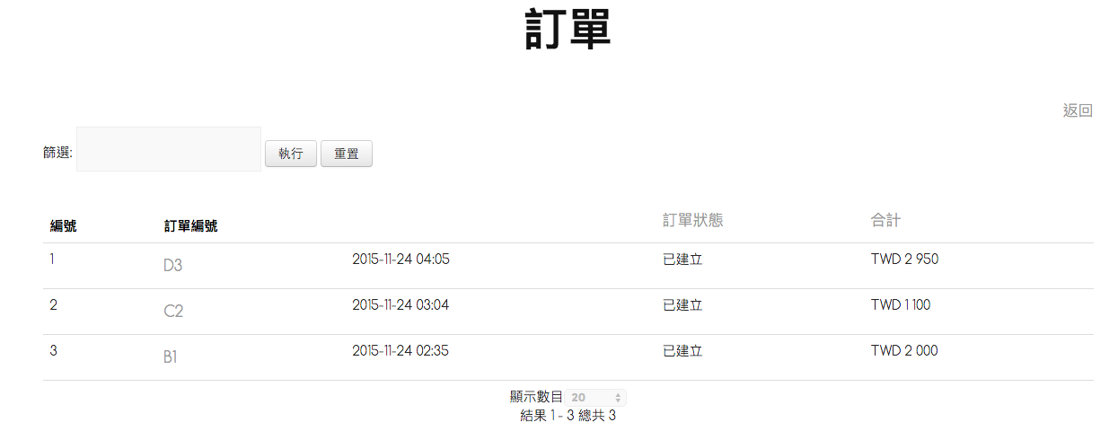

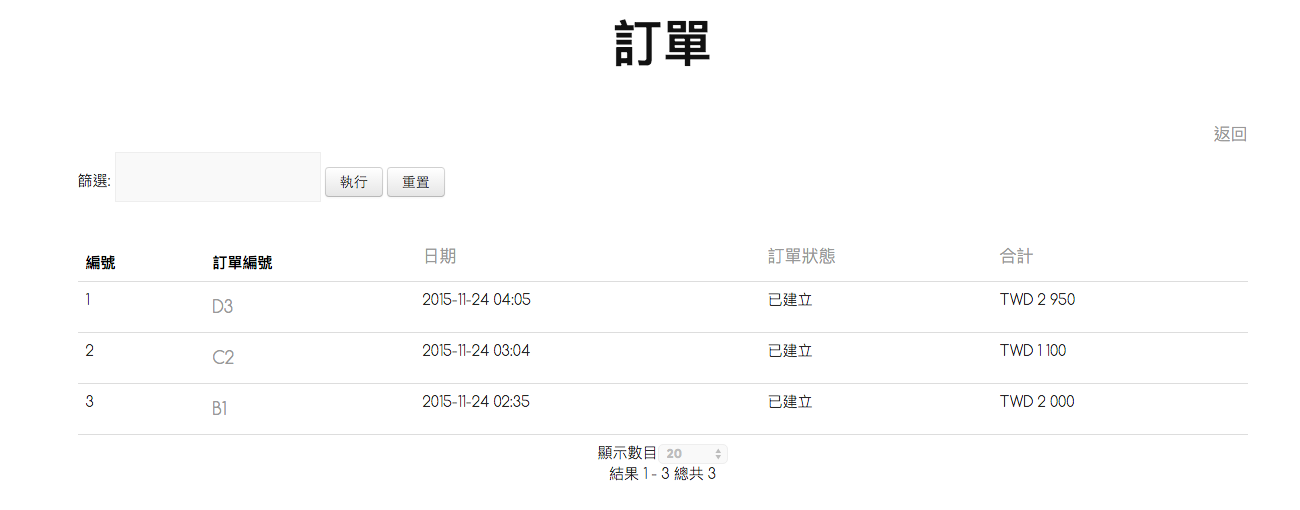

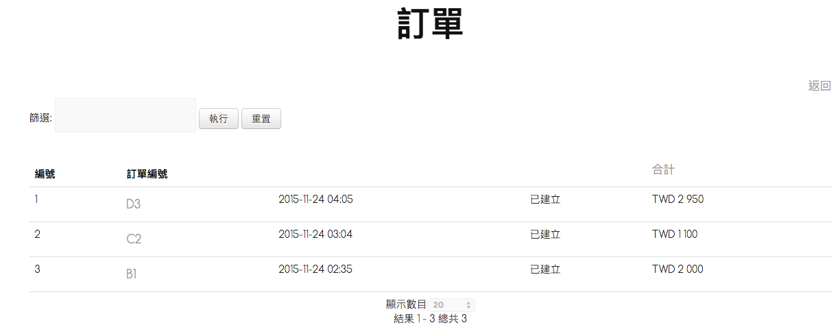

At orders management page,some sorting titles would disappear.
That is , If cursor hover the title but not click it . when leave the title , it will disappear.
You can see the attachment. How to fix the bug?

I process some test, and this issue is from your JSN Page Builder plugin system.
If I desactive this plugin the issue disappear!
This plugin add directly in html element a "display:none" when pointer pass above it...
Contact this plugin developer.
