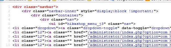

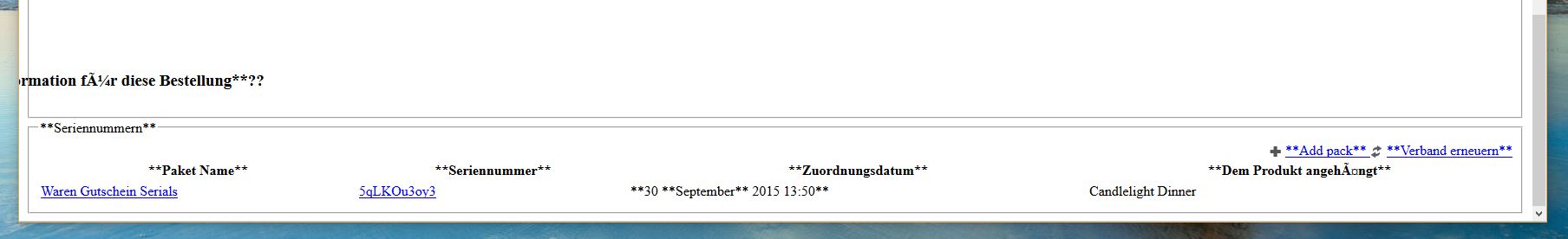

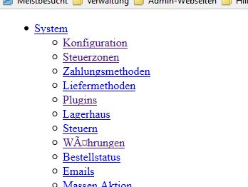

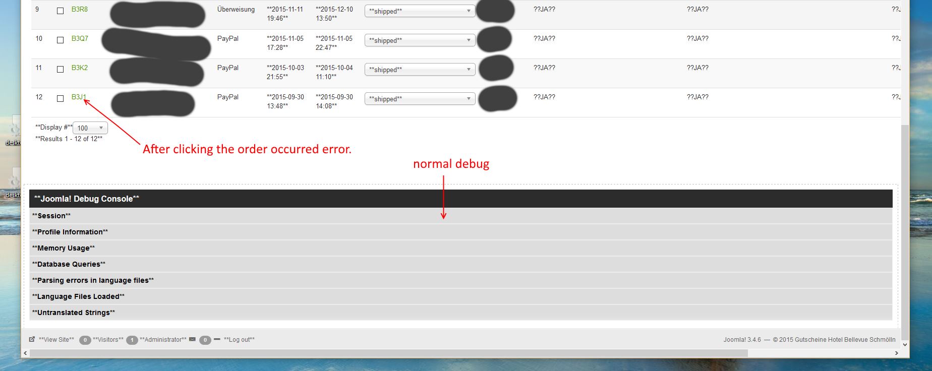

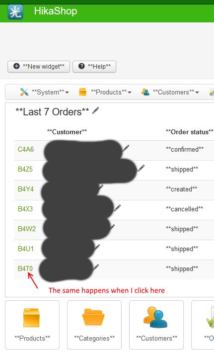

  • Posts: 5
10 years 8 months ago #224766
Hello
I had already tried, it does not work.
See pictures, please.
  • Posts: 86080
  • Thank you received: 14186
10 years 8 months ago #224771
It really looks like a fatal error.
If your server is configured to force the errors to not be displayed, you'll have to look directly in the PHP error log of your server for the fatal error message.
If you don't know how, you might want to contact your hosting company for that.
I see that the error happens at the display of HikaSerial. If you purchase a product without serial, do you have the same problem ?
