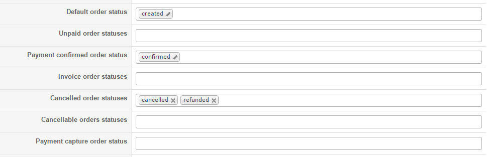

  • Posts: 42
10 years 8 months ago #225022
Order config is at default, screenshot attached.
Also tried cancelling order from the order edit screen, same result, stock not returned.
No errors returned with Joomla debug on, no errors in server PHP log.

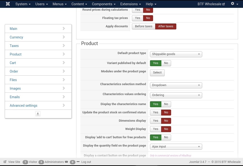

  • Posts: 42
10 years 8 months ago #225068
See screenshot. No mass actions configured. This is actually a fresh install of Hikashop Starter on a fresh default install of Joomla located on a subdomain of my commercial Hikashop site. Not sure if that is a factor. Seems unlikely as the two installs utilize separate databases.

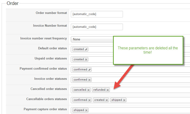

  • Posts: 235
  • Thank you received: 4
9 years 8 months ago #256853
I did everything in this topic to make it work on www.toyscompany.nl .
The stock isn´t corrected on cancellation of an order.
The strange thing is that if I fill orderstatuses in 'cancelled order statuses' t hey are all deleted on save. See attachment.
Jan
