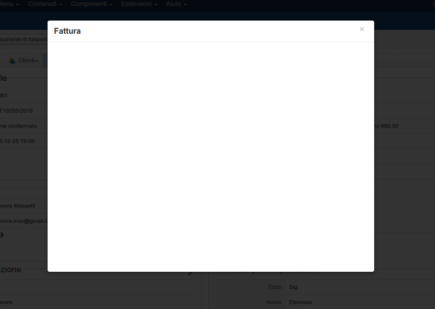

Hallo.
I upgraded to joomla 3.4.8. In my order i cannot print invoice or shipping doc because the popup is blank. This already happend some upgrades before and you comunicated the solution but with different version.
Could you please give advice.

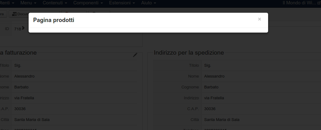

10 years 4 months ago #225209
Add: All popups are blank or cutted

  • Posts: 26358
  • Thank you received: 4066
10 years 4 months ago #225214
Problem is the same than with Joomla 3.4.4 ; 3.4.5 ; 3.4.6 and 3.4.7
