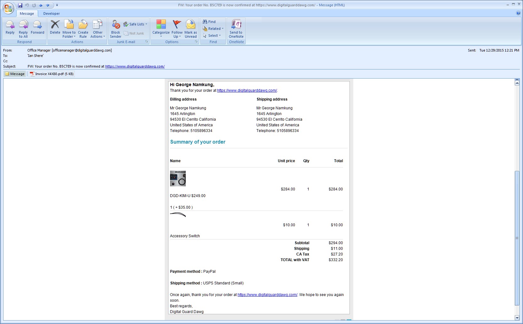

3. The "1 (= $35.00) on the first line of the invoice is for an extra Fob. I suspect that, because it's a characteristic it's cost is being added into the base cost. It would be nice to have this broken out as a separate item - perhaps in the same line as the base item (DGD-KIM-U) rather than a full separate line like the Accessory Switch. I have since added "Extra Fob" after the "1" so it may read better now anyway. However, the client asked if the dollar value is able to be shown in the "Unit Price" and "Price" columns.
4. Refer to Invoice Email. This is the email sent to the client and admin. You'll see that images are inserted and are really screwing with the layout, making everything on the left slide down and not line up neatly with the right hand items. If images must be on in these emails, can we line up the text? Or, alternatively, can we turn the images off? Also, as per #3 above, is it possible to break the characteristics costs out?

4. Images can easily be turned off. Edit the emails via the menu System>Emails, and remove the image tag in the HTML version. Again, there is no PHP code there, only HTML and tags, so it should be easy to find.
For the lines break down, it's the same as point 3.
