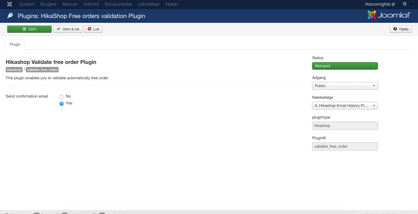

10 years 6 months ago #227786
Why don't you use the "validate free orders" plugin ?
Why are you asking question about a plugin modification when you do not need it ?
Did you see anywhere in our message something which indicate that you need to modify a plugin ?
Why are you complicating the situation when we are just telling you to use one HikaShop plugin ?
You activate the plugin (like it seems to be done in your screenshot) and that's it !
Your free orders will be automatically confirmed instead of just being "created".
  • Posts: 43
10 years 6 months ago #227852
I enabled the plugin before I made this topic. I am sorry if I wasn't clear about that.

10 years 6 months ago #227888
Hello Carsten,
Sorry about our last reply which was a bit harsh, Xavier's reply perfectly described what you have to do so that it work as you want :
To validate free orders, you just have to publish that plugin.
If you want to edit some code to adapt the plugin in a more specific case then the file to edit is:
plugins/hikashop/validate_free_order/validate_free_order.php
However, if you already enabled/published the plugin and your free orders aren't automatically validated there is a problem, so can you show me some screenshots of your configuration and of the result you have with free orders ?
Thank you.
