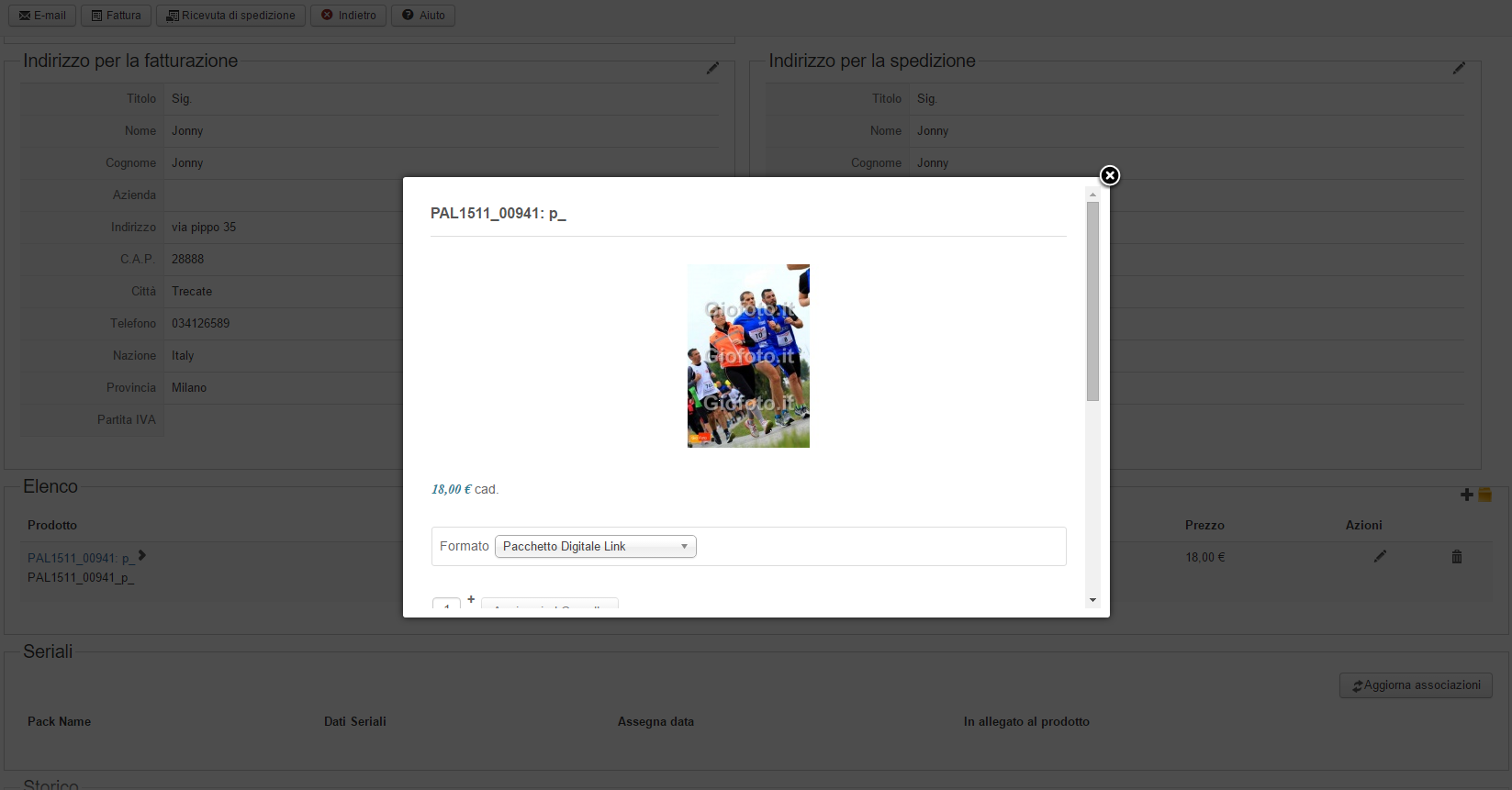

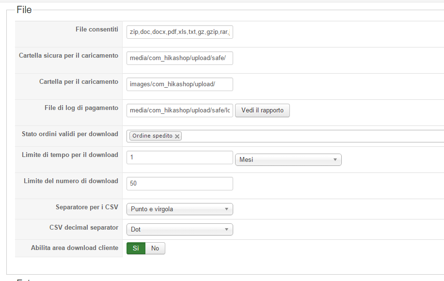

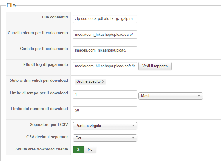

In response to your questions
And would it be possible to know what does your orders have for their order status ?
I include photos 1 and 2
Can you see some files to download when you edit the order in the backend ?
And I include photos 3
Do you see these same files in the front-end when displaying the order (with the customer) ?
