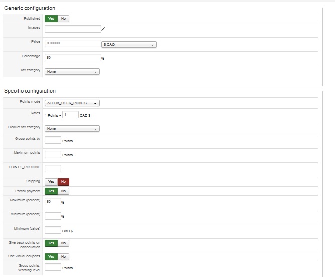

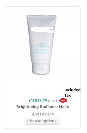

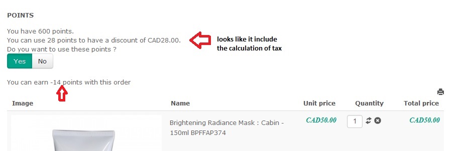

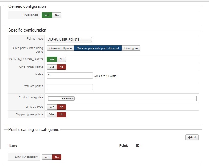

I finally configured the userpoint plugin close to the way i want, but i still have an issue with the points. It seems that the points spent and earned are based on the price after tax rather than before. i have long having an issue with the product price as it always appears with tax. I have a few questions below.
1. How can i configure the points to calculate on product price before tax?
2. If i used Hikashop user point instead of Alphauserpoints. can i have the point displayed on the front page too
3. can i set expiry date on points earned.

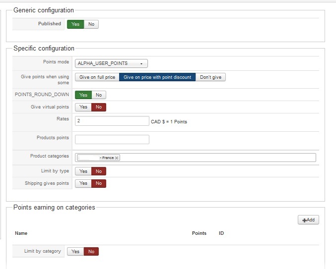

I have attached the print screens of the configurations hopefully you can find out the issue.

1. There is no setting to use untaxed prices instead of taxed prices. It would require the modification of the code in the function getPointsEarned of the file plugins/hikashop/userpoints/userpoints.php in order to use the prices without taxes.
2. There is also no setting to display that value.
However, it should be easy to add pretty much in any view of the frontend with such code:
$user = hikashop_loadUser(true);
echo $user->user_points;
3. There is no such system. That would be quite complex to add as the system isn't made for that. But maybe AlphaUserPoints has a system for their points ? If they do, then you could could use the user points system with them to do that.
4. There is also no option to limit the points gains to only some categories of products.
That could be added to the points caluclations in the getPointsEarned function like in point 1.
Edit Jerome The setting "product categories" allow to filter the products of the selected categories. The settings "Rates" and "Product points" will then only related to the products in the categories you choose.
Last edit: 10 years 6 months ago by Jerome. Reason: Correction on point 4

Regarding question 1: Yes, discounts. But we're not talking about discounts here. We're talking about points. So the law regarding the taxes and discounts doesn't apply to it. Also, we come from Europe and here you have to display prices with taxes and thus it's more logical to base yourself on the price with tax for the calculation of the points.

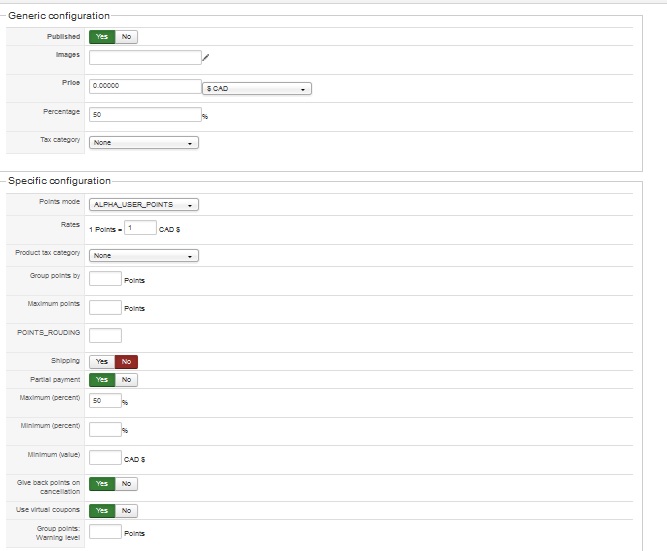

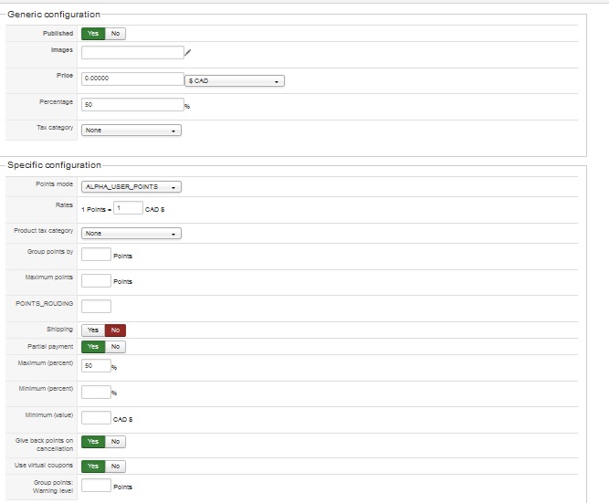

Regarding the answer by Jerome, i think he is referring to the plugin for earning points and I am talking about the Hikashop userpoint payment plugin for payment method, it doesn't come with a configuration to set point payment by categories (please see the attached pic)
Yes, there is a setting of product categories which allow to filter the products of the selected categories in earning points but there is no just setting in the payment plugin.
I really need this feature and i believe it should be there otherwise i can't use this point system even though i have it set 90% right. Is there an alternative except for modification? if modification is necessary so which file is it and how to do it?

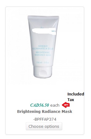

For answer one, may be i can base myself on the price with tax for the calculation of the points. how about my attached pic hikauser_point_1.jpg, where is the setting to have it set to tax excluded.

1. Ah yes, I was also thinking that you were talking about points gains. For the use of the points to be restricted to only some categories, the ideal solution would be to have a generic solution to limit payment methods to categories of products. The problem with that is that you can't have several payment methods for different categories for an order so it's quite limiting because the system would then often display to the customer that he can't purchase finish the order because he has products from categories with different payment methods attached.
So no, there is no solution in that case with the options available. But it could be added quite easily to the user points payment plugin with a small modification of the code.
In the file plugins/hikashoppayment/userpoints/userpoints.php in the function onPaymentDisplay, you could add a check on the categories of the products (that you can find in the array $order->products). Just return before the call to parent::onPaymentDisplay($order, $ordered_methods, $usable_methods); when there is at least a product from a category for which you can't pay with points and that will remove all the user points payment methods from the selection of the payment methods.
2. I don't understand your question. In your hikauser_point_1.jpg I see a product on a listing of products. Where is the link with the points ? If you want to have that price displayed as untaxed, edit your menu item via the Joomla menu manager, and in the "products options" tab, turn off the "show taxed prices" setting.
