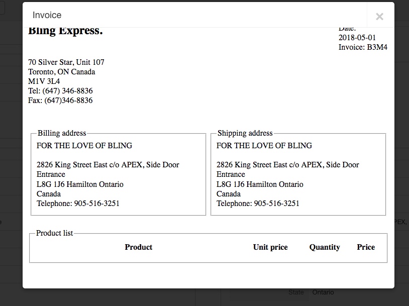

I am using HikaShop Business 2.6.3 and have the same problem. I added the codes in the invoice file of view of order as shown above, but nothing happened. Please help. Your help would be greatly appreciated!

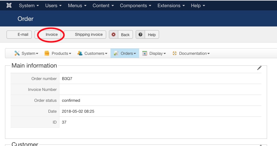

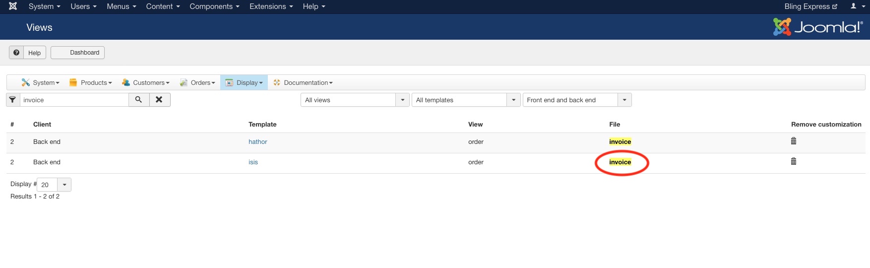

I am talking about the invoice that the merchant can print on the backend. The INVOICE file that I edited is shown below:
Display- View - invoice
Client: Back end
Template: isis
View: order
File: invoice
thanks again!
Have a great day!

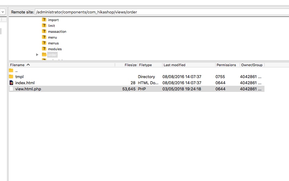

  • Posts: 85796
  • Thank you received: 14091

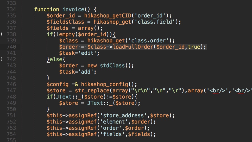

8 years 2 months ago #292239
Then please try to also change the line:
$order = $class->loadFullOrder($order_id);
to:
$order = $class->loadFullOrder($order_id, true);
in the file administrator/components/com_hikashop/views/order/view.html.php and that should help.
  • Posts: 10
8 years 2 months ago #292270
Thanks for your quick reply!
I just made the change according to your suggestion, but the product images did not show up, instead, my all orders on backend invoice are missing.
Please help.
thanks again
  • Posts: 85796
8 years 2 months ago #292282
I don't see why it would do that.
So if you revert the change, do you confirm that you get back the products ?
I did test the change on my end, but that was on HikaShop 3.4.0, and it worked just fine. I had a look at the code of your version of HikaShop and didn't see why it wouldn't work the same.
I'm afraid it will require hiring a developer to help you with that customization in order to debug the issue.

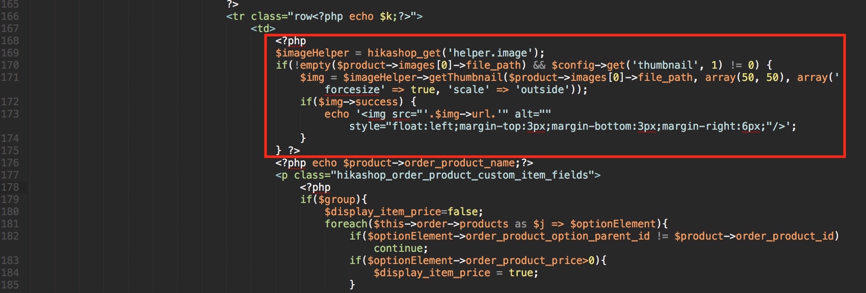

  • Posts: 10
8 years 2 months ago #292296
Hello Nicolas,
Before I move on to find a solution, can you please confirm I am using the right codes in INVOICE file that I edited as shown in the attachment.
Client: Back end
Template: isis
View: order
File: invoice
Thanks again!
Have a wonderful one!
  • Posts: 85796
8 years 2 months ago #292314
That looks correct yes.

  • Posts: 56
8 years 1 month ago #293281
I've made the modifications to invoice file and to administrator/components/com_hikashop/views/order/view.html.php, but when I add the second parameter true to loadFullOrder method in invoice page inside the product lists i see these 2 error (I have PHP error reporting ON):
Notice: Undefined variable: config in /home/siti/www.sushitalia.com/sushitalia.com/htdocs/administrator/templates/isis/html/com_hikashop/order/invoice.php on line 170
Fatal error: Call to a member function get() on null in /home/siti/www.sushitalia.com/sushitalia.com/htdocs/administrator/templates/isis/html/com_hikashop/order/invoice.php on line 170
I have HikaShop 3.4.0 on Joomla 3.8.3
What is the problem ?
Many thanks
Last edit: 8 years 1 month ago by trik84.
8 years 1 month ago #293297
In that case, you should probably add that line :
$config = hikashop_config();
just before :
$imageHelper = hikashop_get('helper.image');
And it should do the job.
Best regards,
Mohamed Thelji.

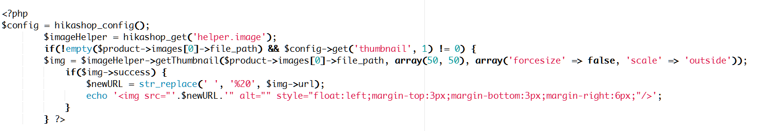

3 years 11 months ago #343634

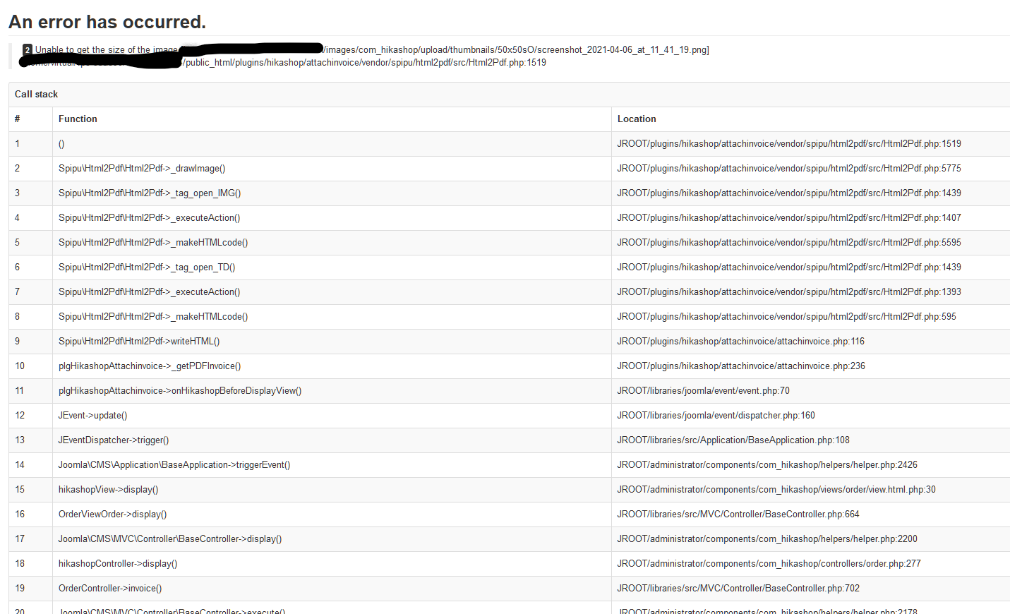

I have used this code in the attach invoice plugin to successfully get the product images in the pdf invoice. It all worked fine, but then over the weekend, I started to receive this error:
An error has occurred.
2 Unable to get the size of the image
I'm not sure why this is the case? The URL path to the image is correct and works fine. Do you have any ideas please?
This is for EVERY image on any order. This isn't any particular image.
Last edit: 3 years 11 months ago by grayt7.

  • Posts: 376
  • Thank you received: 7
3 years 11 months ago #343658
hi,
The edited file:
public_html/plugins/hikashop/attachinvoice/attachinvoice/invoice.php
With the attached code (image)
The error is also attached with debug etc turned on.
Yes removing the code makes the invoice work.
Hope you can help,
Many thanks
  • Posts: 85796
3 years 11 months ago #343664
This error indicates that the image file is not found.
Can you confirm that the file is at the place the system is looking at ?
As you hide the beginning of the paths in your screenshot, I can't say for sure but it seems that it's missing the "public_html" part in the path of the image.
So you probably need to modify $newURL to prepent that folder to it or even prepend the URL of the website so that it uses a full URL and not a local relative path.
