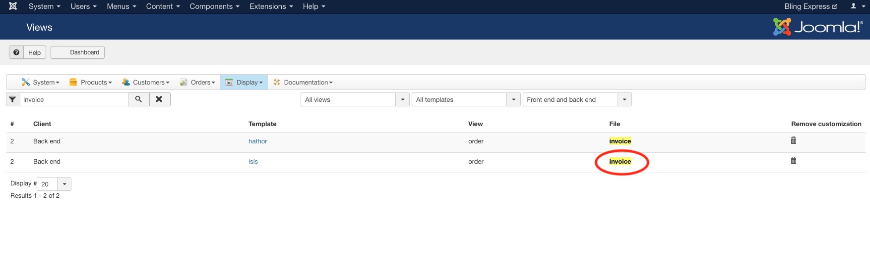

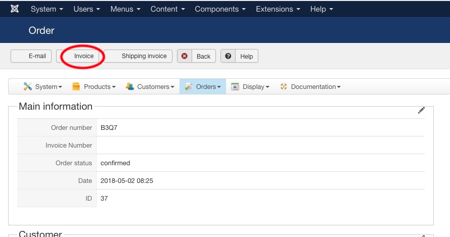

I am talking about the invoice that the merchant can print on the backend. The INVOICE file that I edited is shown below:
Display- View - invoice
Client: Back end
Template: isis
View: order
File: invoice
thanks again!
Have a great day!

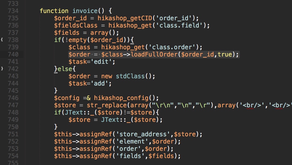

Then please try to also change the line:
$order = $class->loadFullOrder($order_id);
to:
$order = $class->loadFullOrder($order_id, true);
in the file administrator/components/com_hikashop/views/order/view.html.php and that should help.

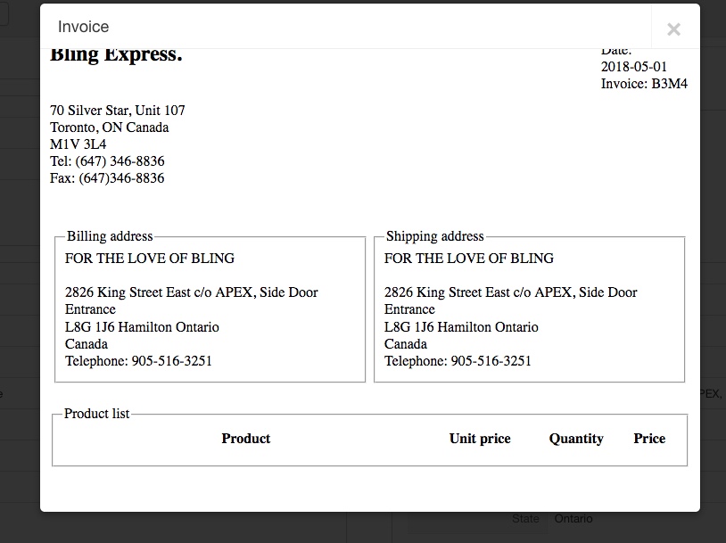

  • Posts: 10
8 years 3 months ago #292270
Thanks for your quick reply!
I just made the change according to your suggestion, but the product images did not show up, instead, my all orders on backend invoice are missing.
Please help.
thanks again

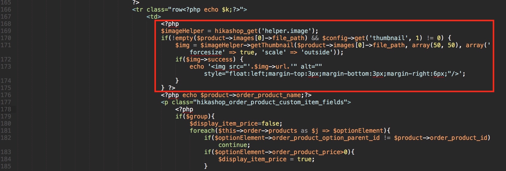

Before I move on to find a solution, can you please confirm I am using the right codes in INVOICE file that I edited as shown in the attachment.
Client: Back end
Template: isis
View: order
File: invoice
Thanks again!
Have a wonderful one!
  • Posts: 86077
  • Thank you received: 14186
8 years 3 months ago #292314
That looks correct yes.

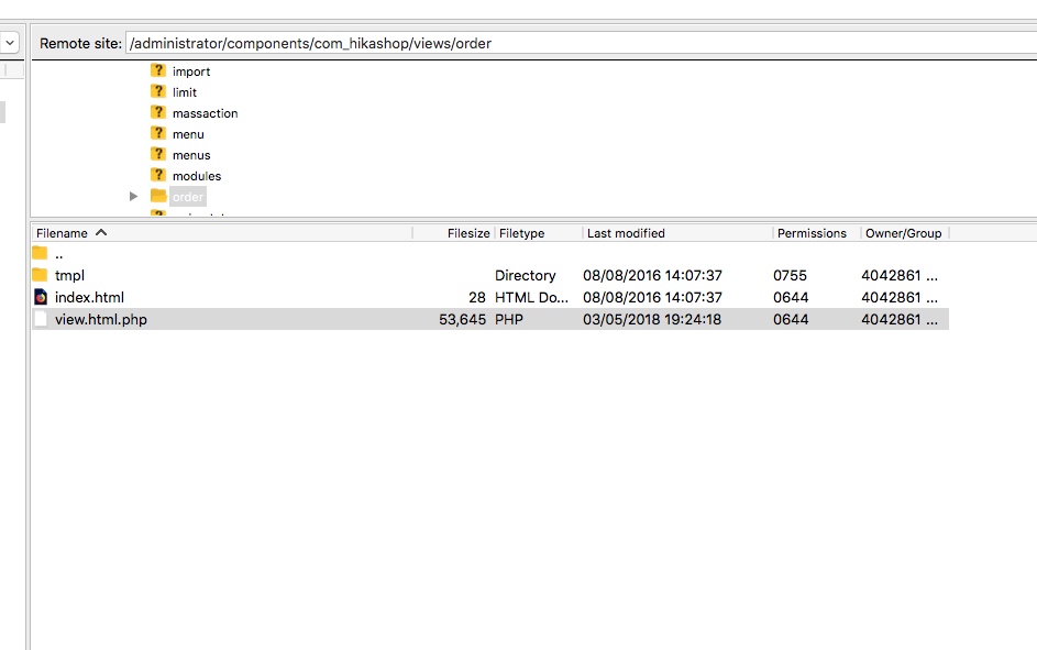

  • Posts: 56
8 years 2 months ago #293281
I've made the modifications to invoice file and to administrator/components/com_hikashop/views/order/view.html.php, but when I add the second parameter true to loadFullOrder method in invoice page inside the product lists i see these 2 error (I have PHP error reporting ON):

8 years 2 months ago #293297
In that case, you should probably add that line :
$config = hikashop_config();
just before :
$imageHelper = hikashop_get('helper.image');
And it should do the job.

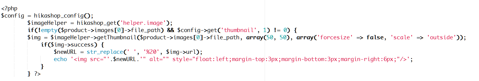

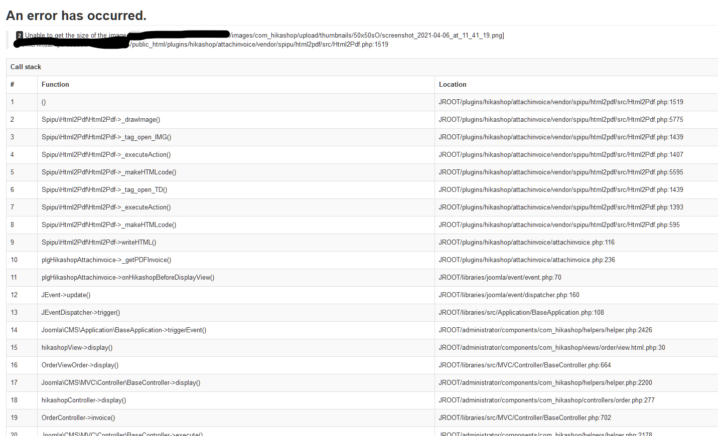

4 years 3 weeks ago #343634
I have used this code in the attach invoice plugin to successfully get the product images in the pdf invoice. It all worked fine, but then over the weekend, I started to receive this error:
An error has occurred.
2 Unable to get the size of the image
I'm not sure why this is the case? The URL path to the image is correct and works fine. Do you have any ideas please?
This is for EVERY image on any order. This isn't any particular image.
Last edit: 4 years 3 weeks ago by grayt7.
4 years 3 weeks ago #343637
We will need more elements to better progress on your subject, can you provide these elements :
- Error screenshot WITH the Joomla Debug activated (and in maximum level)
- Did you do an update a week ago (HikaShop or else)?
- OR even a customization of the attach invoice plugin code?
=> A test can be useful, process a try with the attach invoice unpublished, then you can see the result in Backend order form listing and by clicking the button invoice to have a preview.
Awaiting your precise returns to be able to progress on your subject.
Last edit: 4 years 3 weeks ago by Philip.

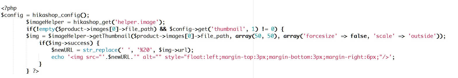

  • Posts: 376
  • Thank you received: 7
4 years 3 weeks ago #343658
hi,
The edited file:
public_html/plugins/hikashop/attachinvoice/attachinvoice/invoice.php
With the attached code (image)
The error is also attached with debug etc turned on.
Yes removing the code makes the invoice work.
Hope you can help,
Many thanks
  • Posts: 86077
4 years 3 weeks ago #343664
This error indicates that the image file is not found.
Can you confirm that the file is at the place the system is looking at ?
As you hide the beginning of the paths in your screenshot, I can't say for sure but it seems that it's missing the "public_html" part in the path of the image.
So you probably need to modify $newURL to prepent that folder to it or even prepend the URL of the website so that it uses a full URL and not a local relative path.
