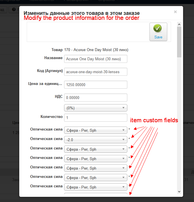

The problem appears when I want to edit the order on the backend.
In the popup's window for editing product there are all my item custom fields.
And the same is in the popup's window for adding product to order.
Thank you forward

I may be not clear to describe it above.
The problem is that all item custom fields are display in popup, not only item custom fields allowed for the product.

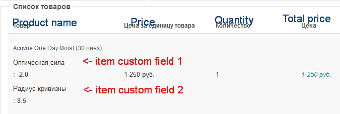

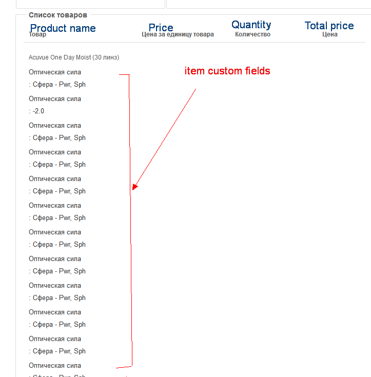

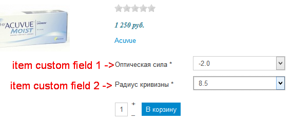

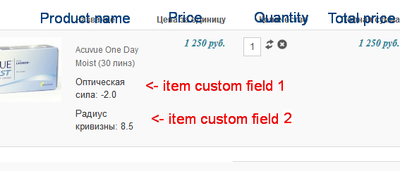

10 years 1 month ago #231298
I do not understand why you need to show the fields that are specified for other products.
Furthermore, after saving the information, all the fields appear in the order, even if nothing is changed.
Look at the screenshots:
1. The product page. There are two item custom fields. All is fine.
2. The checkout page. All is fine too.
3. The order's show on user control panel. All is fine too.
4. The popup to edit product. I just save it whithout editing.
5. The order's show on user control panel after previous step. All fields are here.
And if I try to add new product to the order I get all fields in order show again.
