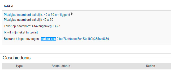

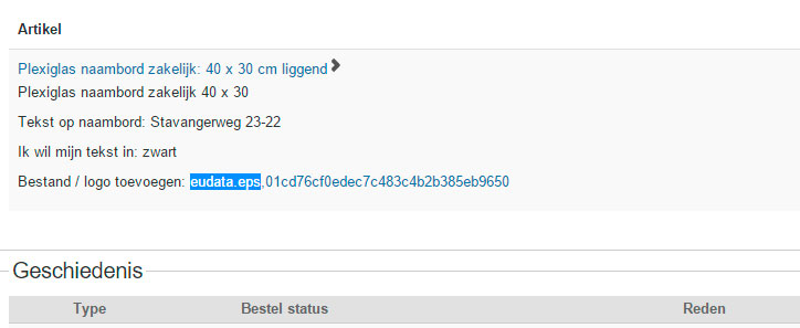

There seems to be a kind of bug in the ajax upload on the frontside. The file that's being uploaded is getting a strange name in the database, so the link to download the file in the backend gives an error (file not found). The name of the file in the folder upload/safe is the original one (in case of the screenshot eudata.eps). Can you please take a look at this? I think this occurs when a client uploads the same file twice (as it doesn't happen all the time).
www.jouwnaambord.nl/naamborden/aluminium-naambord-zakelijk
B.R.
Michel

10 years 5 months ago #232113
That's really strange.
I've tried on my end and we don't have that problem with the latest version.
And I've tried on your website and the problem is there even for new files.
I've also checked the log of changes on the AJAX upload of custom fields and it didn't change for quite a while.
Did you always had the problem ?
Did you install something recently which could have caused that ?
Are you using other extensions linked with HikaShop ? Or did you develop custom plugins for HikaShop ?

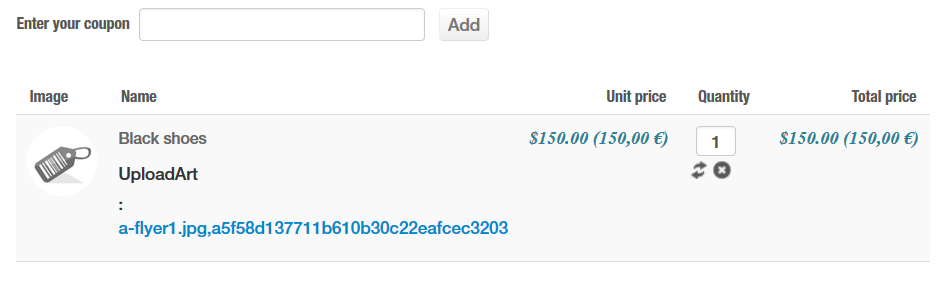

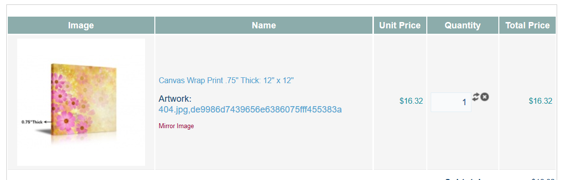

On our site the custom field type "file" doesn't work at all, so I changed this to "Ajax File" and I am seeing the same issue with a strange file name being displayed in the cart. This which would be confusing to the customer, and the name it causes the cart display to look odd.
In trying to determine if this may be caused by some other component on our site, I did a fresh installation of Joomla 3.x, upgraded it to 3.5.1, installed Hika 2.6.3 with sample data, added a custom item field of type "Ajax File" and noted the issue - screen capture of the cart below.

Thank you for your feedback. That's a bug of the 2.6.3
We've added a patch on our end to fix the problem. Download the install package on our website and install it on your website and try with a new add to cart and that should fix the problem.

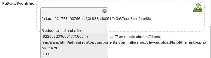

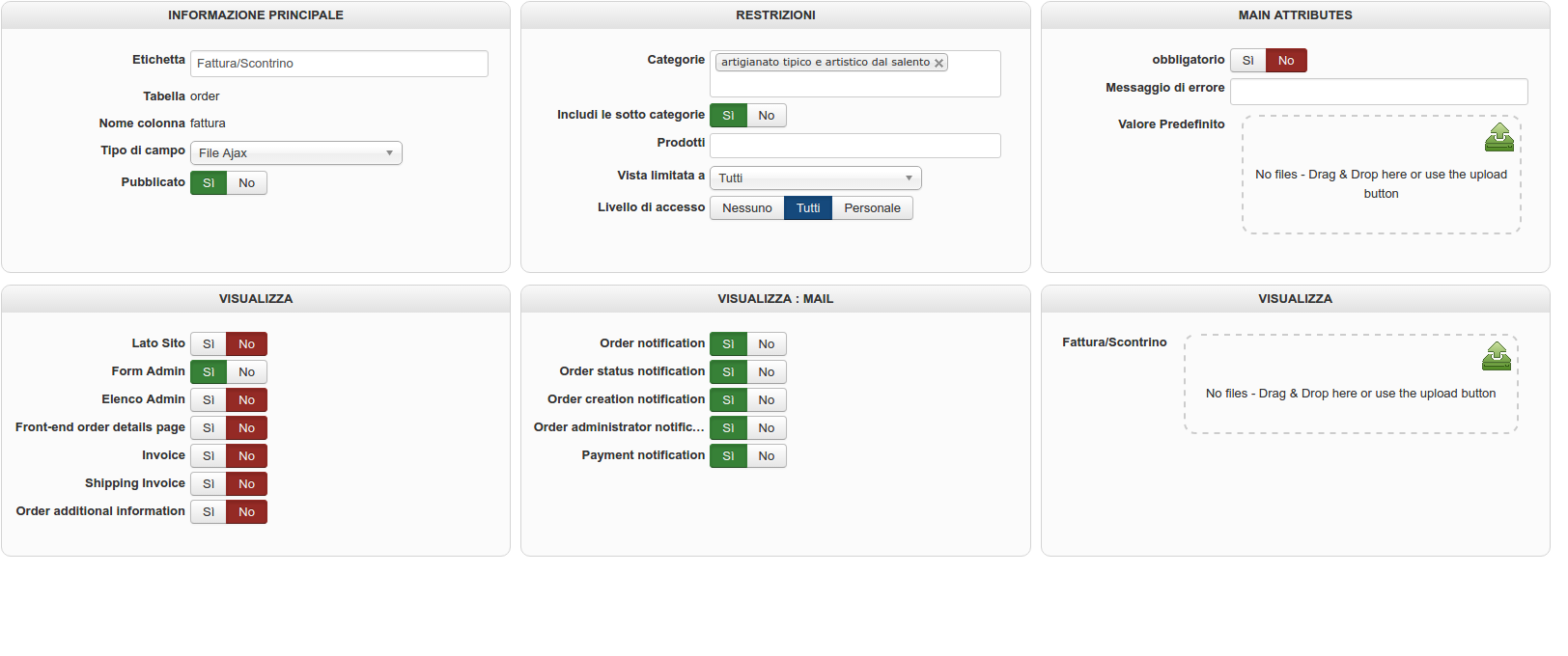

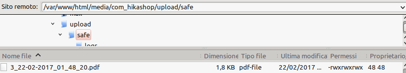

sorry if I open the thread, but I have the same problem that has occurred since I upgraded to version 3.0 of hikashop. The ajax uploaded files are renamed, and so it is impossible to download them.
I attach screenshots
Backend custom field
file name in the folder
file name in backend
You can see if it works? Thank you

  • Posts: 113
9 years 4 months ago #267268
the custom field is in the table "order" and only appears in the email view.
Load the file and then save. After saving the file is renamed. After I open and I see this error message:
The field of custom settings are the same as always, but the problem occurs after I upgraded to version 3.0 of hikashop. In fact, I checked all the orders and the problem starts to occur after the update.

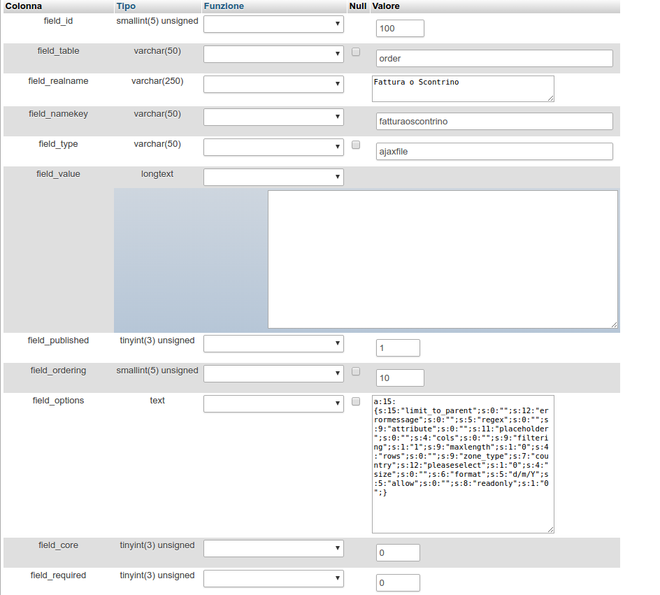

  • Posts: 113
9 years 4 months ago #267327
Hello Jerome,
Thank you for the reply.
the field do not haven edited in another place. It worked smoothly before February 12, the day in which I upgraded to version 3.0.
I attach screenshot of the database. What should I change to remove the security check?
Thank you
9 years 4 months ago #267329
I wasn't clear enough.
You need to edit the field column where the data is stored.
So not the hikashop_field table ; but the table of the custom field: hikashop_order in your case because it's an order custom field.

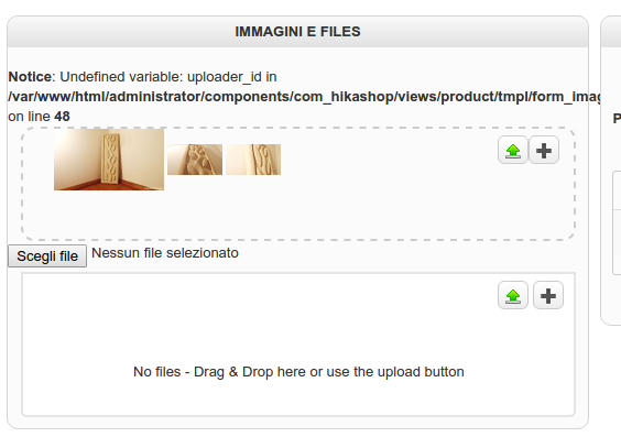

  • Posts: 113
9 years 4 months ago #267764
hello Nicolas,
after installing the patch I can not upload, edit or delete images of products.
Error:
Notice: Undefined variable: uploader_id in /var/www/html/administrator/components/com_hikashop/views/product/tmpl/form_image.php on line 48
I attach screenshots.
Thanks in advance!
Last edit: 9 years 4 months ago by gioxd.
9 years 4 months ago #267765
Please re-download HikaShop 3.0.1 ; when Nicolas integrated the patch and updated the package, one patch where missing and during a short period, the packages had the issue.
But we added the missing patch so it should be far better now !
