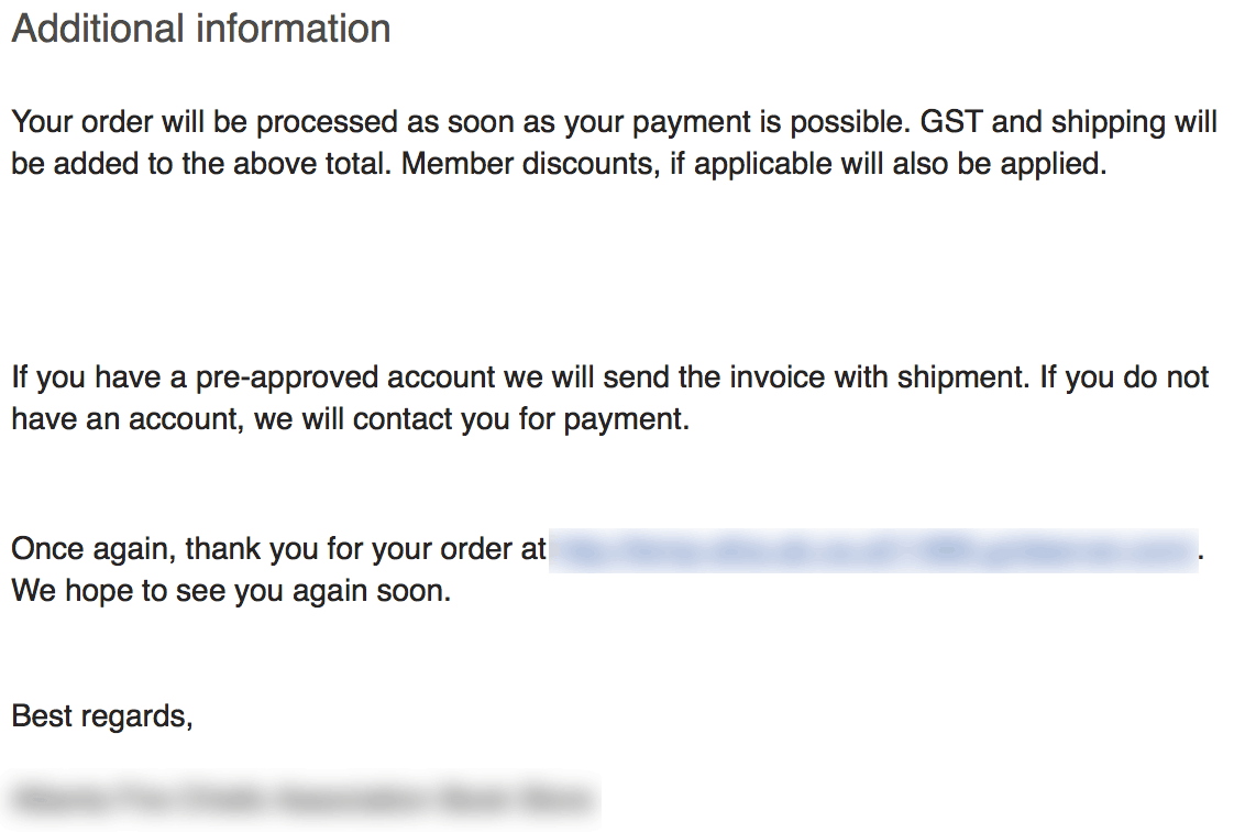

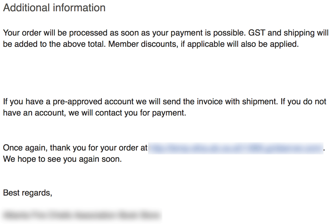

Here is the raw output from the customer creation email message. You see the br's in the output. Those are the ones I would like to remove. I have also attached a screenshot showing the rendered output.
<h4>Additional information</h4>
<p>Your order will be processed as soon as your payment is possible. GST and shipping will be added to the above total. Member discounts, if applicable will also be applied.</p><p><br/><br/>If you have a pre-approved account we will send the invoice with shipment. If you do not have an account, we will contact you for payment.</p>

10 years 5 months ago #234043
1. So you want to edit the order creation notification via the menu System>Emails, and in the preload version, you want to remove the <br/> tags in that piece of code near the end:
if($data->order_payment_method=='banktransfer'){
			echo '<p>' . JText::sprintf('PLEASE_TRANSFERT_MONEY',$amount).'<br/>'.$information.'<br/>'.JText::sprintf('INCLUDE_ORDER_NUMBER_TO_TRANSFER',$data->order_number) . '</p>';
		}elseif($data->order_payment_method=='check'){
			echo '<p>' . JText::sprintf('PLEASE_SEND_CHECK',$amount).'<br/>'.$information.'<br/>'.JText::sprintf('INCLUDE_ORDER_NUMBER_TO_CHECK',$data->order_number) . '</p>';
		}elseif($data->order_payment_method=='purchaseorder'){
			echo '<p>' . JText::sprintf('PLEASE_SEND_PURCHASEORDER',$amount).'<br/>'.$information.'<br/>'.JText::sprintf('INCLUDE_ORDER_NUMBER_TO_PURCHASEORDER',$data->order_number) . '</p>';
