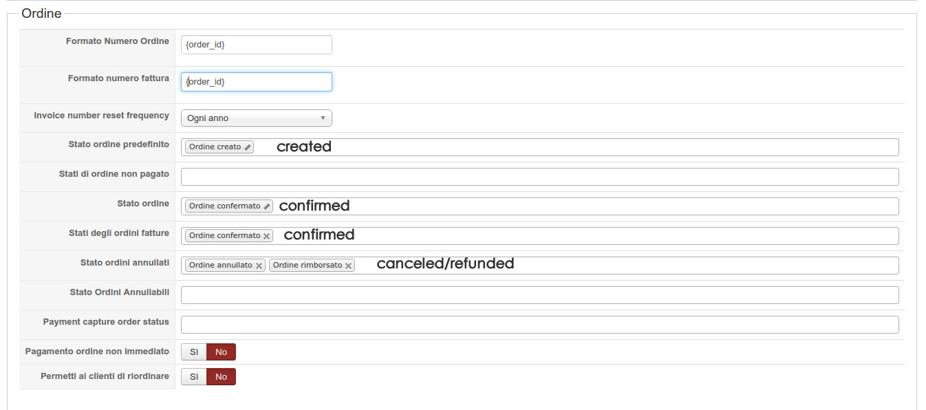

  • Posts: 3
10 years 4 months ago #236645
As you can see by the screenshot attached, all the fields have been compiled in the correct way.
Is there a way to make Hikashop generate invoices only for confirmed orders?
Thanks again
  • Posts: 86079
  • Thank you received: 14186
10 years 4 months ago #236703
Well, that should be the case for the customers. On the backend, you can print invoices whenever you want regardless of the status. It's just more practical but I don't see a problem with that.
