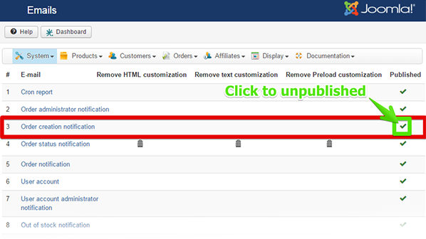

10 years 4 months ago #236660
Yes can switch this off, for this go to Components => HikaShop => Configuration, then go on System dropdown and select Emails
You will see email listing, the you can unpublished just by clicking on the little icon check.
Hope this will fit your needs.

10 years 4 months ago #236710
Thank you @Philip for the reply.
This is exactly what I needed and I really appreciate your help on this. It would have taken me a long time to find that on my own.
