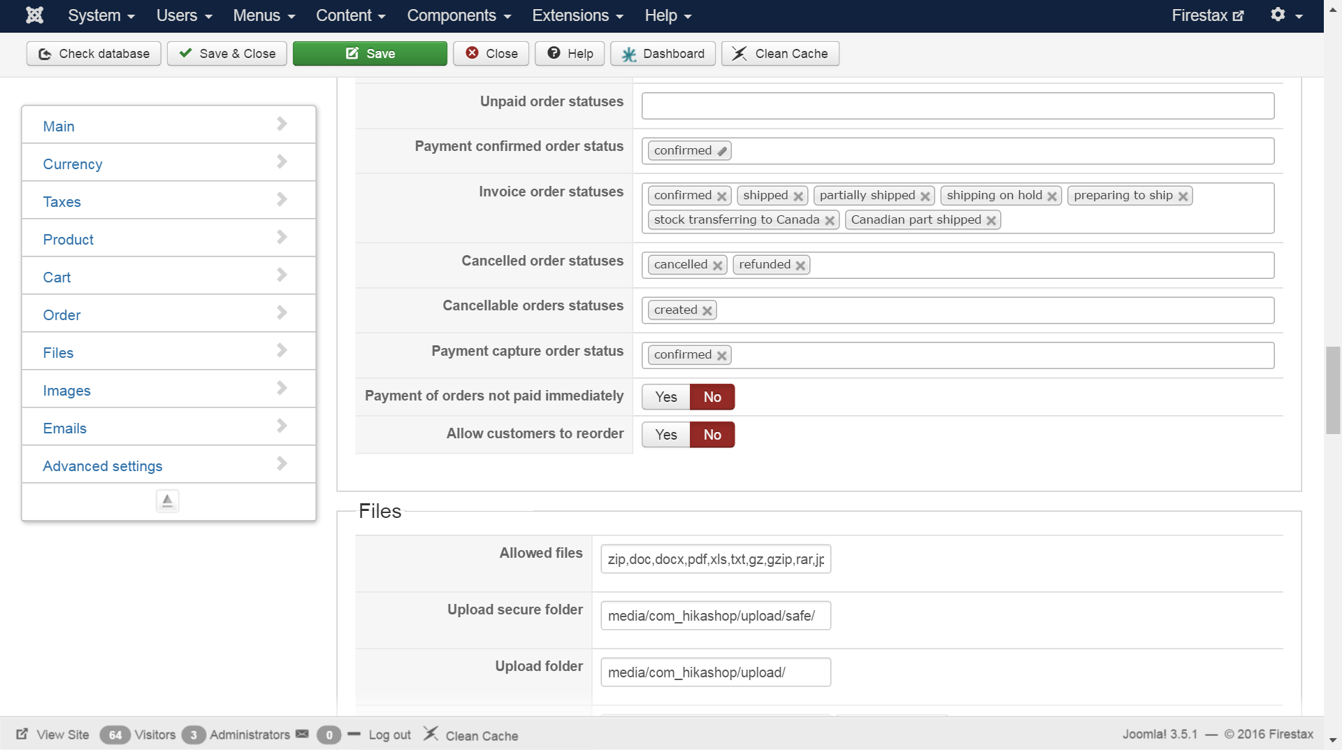

Just noticed that since the update I don't have all of our invoice statuses anymore. It shows them and lets me select them all but when I hit save it only saves 7. Is there a limit?

I just deleted one to see if there were limits. It deleted it but I can't add any that were not already there. It will only add the ones you see. Even if I delete all of these then select another one that is not shown.

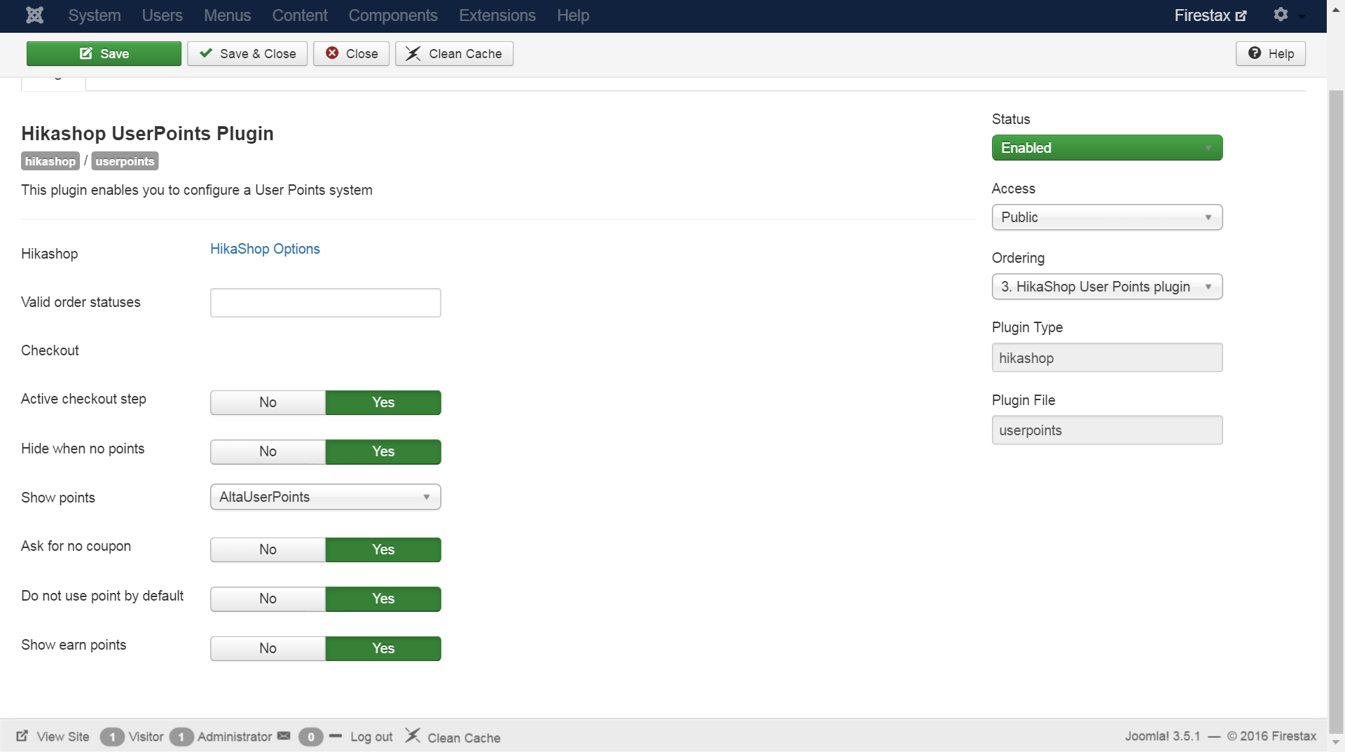

The problem this is causing is when an order is changed from "Stock Transferred to UK" on an order that used points. It would take the points again when changed to ship. How can I add all of my "Invoice Statuses" so this does not occur? Thanks.
Can I just add them here? I was advised before to leave this blank.
