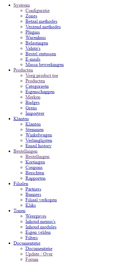

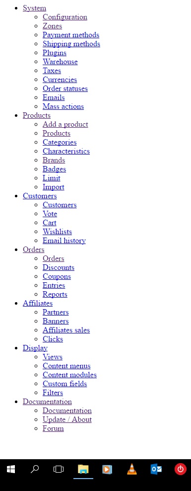

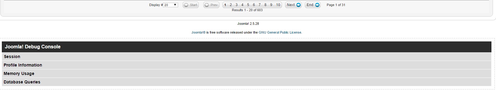

  • Posts: 34
10 years 4 months ago #238003
i enabled the option "Error Reporting" of the Joomla configuration, and i see the "Joomla Debug Console" under every page (see attachment 01) but when I try to open a Order, i only see the page from attachment 02 without the "Joomla Debug Console".
what could be the problem?

10 years 4 months ago #238016
So maybe your server is configured to force the non display of error messages.
Then instead, please look in the PHP error log of your server for the fatal error message which has been logged when you displayed that page and provide it.
Only with the error message can we say what could be the problem since we don't have it on our end and don't know what it could be.
