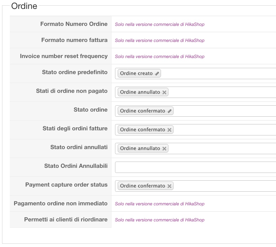

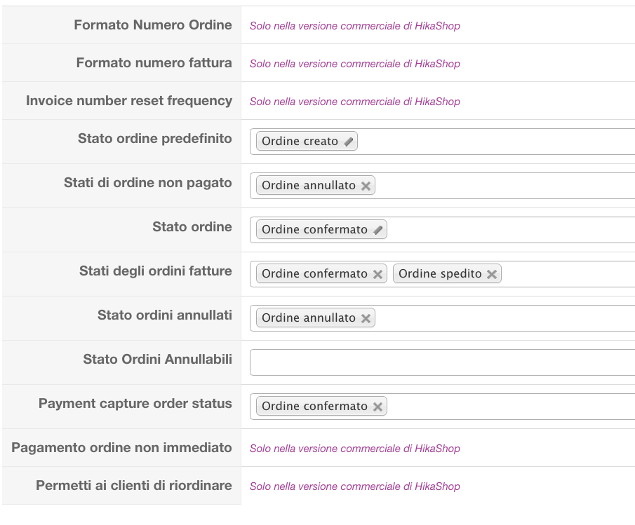

Hallo, it seems to me that in my orders control panel , missing just the voice PAYMENT ORDER STATUS CONFIRMED . And ' one of my HIKASHOP version or problem ??
I attach files, Goog evening
  • Posts: 86079
  • Thank you received: 14186
10 years 3 months ago #238318
If your orders status is not changed to "confirmed" automatically after the payment, it means that the problem is that HikaShop is not receiving payment notifications.
So I invite you to follow this documentation in order to find from where the problem is coming:
www.hikashop.com/support/documentation/i...or.html#notification
