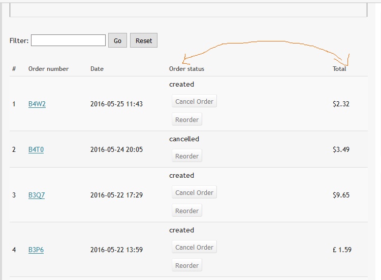

Hi, attached a screenshot. I would just like to swap positions in the user control panel , hence the buttons for reorder and cancel at the end. Thanks for your quick help. Shop is going live soon now.

To do it you'll have to directly edit the code of the file "Listing" of the "Order" view of your front-end template via "Hikashop->Display->Views".

10 years 3 months ago #241194
Hi and thank you. I tried that too, but it just swaps the title, the buttons and the amount still remain in the same position. Can you please point out what line or code I must swap in the php file?

10 years 2 months ago #241196
The two elements you looking for start in line 168 and end line 178 for the "Order status" column AND in line 179 and end line 181 for "Total" column.
And so you have to switch them, more precisely put the "Total" column first, and after "Order status" column.
