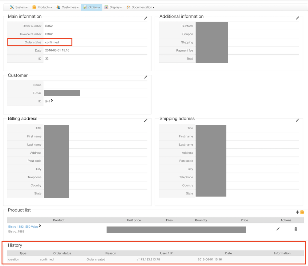

  • Posts: 4
10 years 2 months ago #243645
Thank you for your help.
I've attached one of the orders where we didn't receive payment.

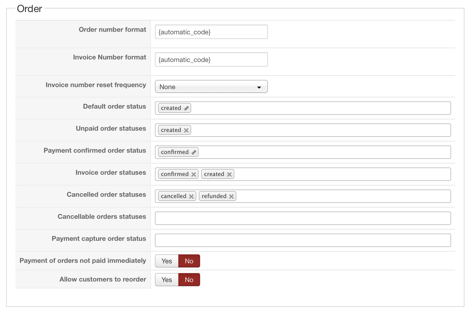

We have adjusted our settings as per your advice (second file attached). Will these settings resolve the issue we were having?
  • Posts: 86079
  • Thank you received: 14186
10 years 2 months ago #243648
Hopefully.
How were they set before ? If the default order status was confirmed instead of created, then yes, it's highly likely that the issue came from that.
