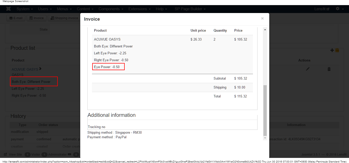

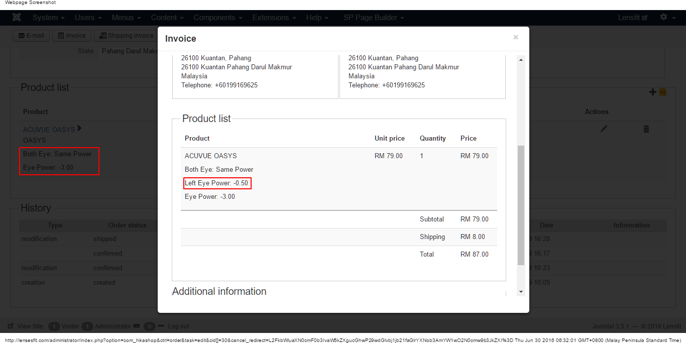

We have a custom field display limited to "both eye - different problem"
it did work well by not display all the while at checkout process and front end order as well as backend order detail page
however, when we click on invoice, this field come out from nowhere and have a value do not know come from where and same problem occur for field limited to "same power"
please see screen shot below

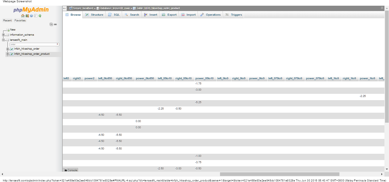

We did a check on order_product if there is any value in database, but we are sure it is empty and fine as expected

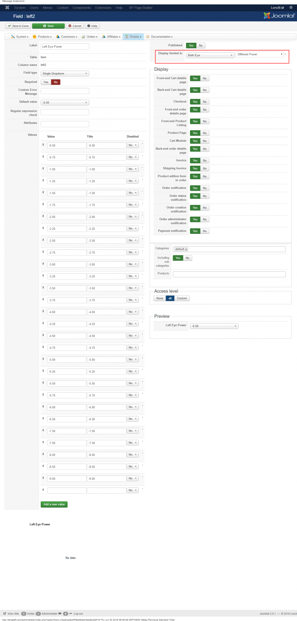

and this is the setting of the problem field which should not display in invoice
the main point of this problem is the left eye field should have no reason to display in invoice

And your screenshots are not consistent, so we're not sure that the field is not empty.
In your custom field settings screenshot, you're displaying the field "left2", but that column is not in your screenshot of your phpmyadmin.

attached the database screen shot, this is quite obvious the left2 is empty, we also quite suprise how did the script find the value and enable it to be display

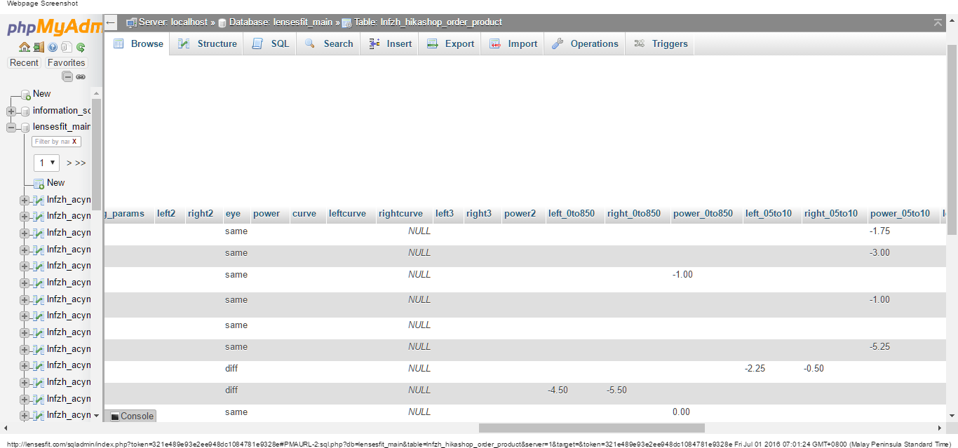

Please see this screen shot, we are sure that database is empty, if not the order detail part would not show correctly, however, during invoice detail it display the empty field with a default value, all these problem arise when using the "display limited to" function

We are very sure that the database value is empty for the printed error field

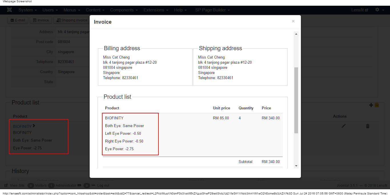

and it make the scenario worst
please see below screen shot, after rebuild category, more unexpected field is shown in invoice
i have send a link download the full akeeba backup of the site from contact form, can nicolas help to check on it (since nicolas have better understanding on this kind of bug)? or it is prefer to pass you the joomla access ?
