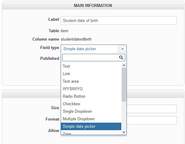

Please make sure that you're using a custom field of the type "advanced date picker" and not "simple date picker".

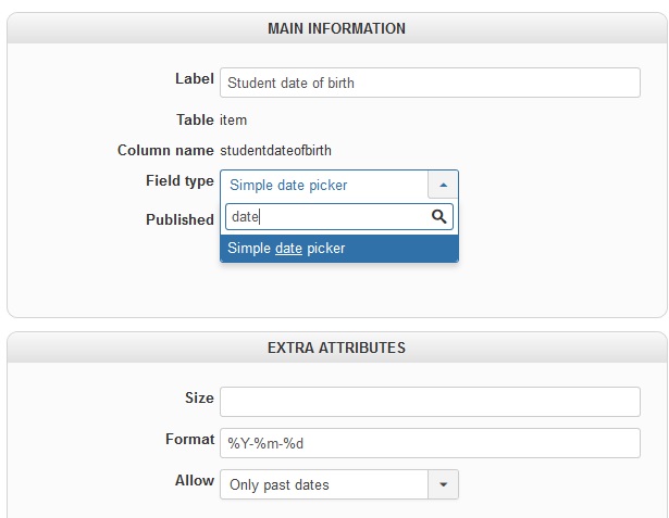

We have had this issue also, when i checked the options advanced is not shown.
Hikashop Version 3.2.1
Joomla 3.8.2
PHP 7.1.11
  • Posts: 127
  • Thank you received: 8
8 years 6 months ago #283956
Found the option;
You have to go to Extensions: Manage and refine the search with 'Hika Date'
Then you have to enable 'Hikashop Date Picker Plugin'
Once this is enabled you can then select 'Advanced date picker'
