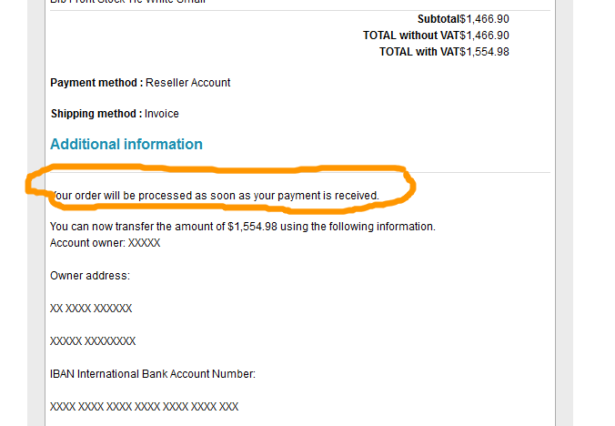

Is there a way to remove the phrase .." your product will be shipped as soon as payment is received" from the customer order emails?

See: www.hikashop.com/download/languages.html#modify
ORDER_VALID_AFTER_PAYMENT="Your order will be processed as soon as your payment is received."

Can you provide me instructions for removing "Your order will be processed as soon as your payment is received.".
Maybe you can give a step by step example would be helpful.

You can use a translation override to change that text. So Jerome gave you a link which explains how to do a translation override, and the translation key to use.
So you'll want to add such override in your translation:
ORDER_VALID_AFTER_PAYMENT=""
And that will remove that text.
