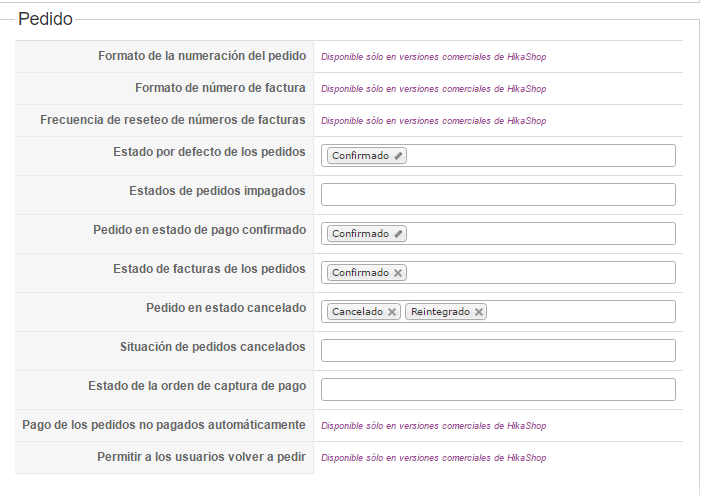

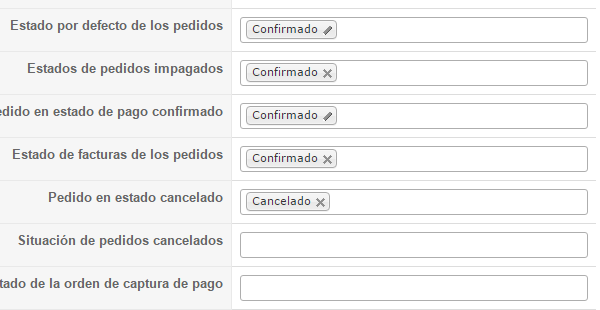

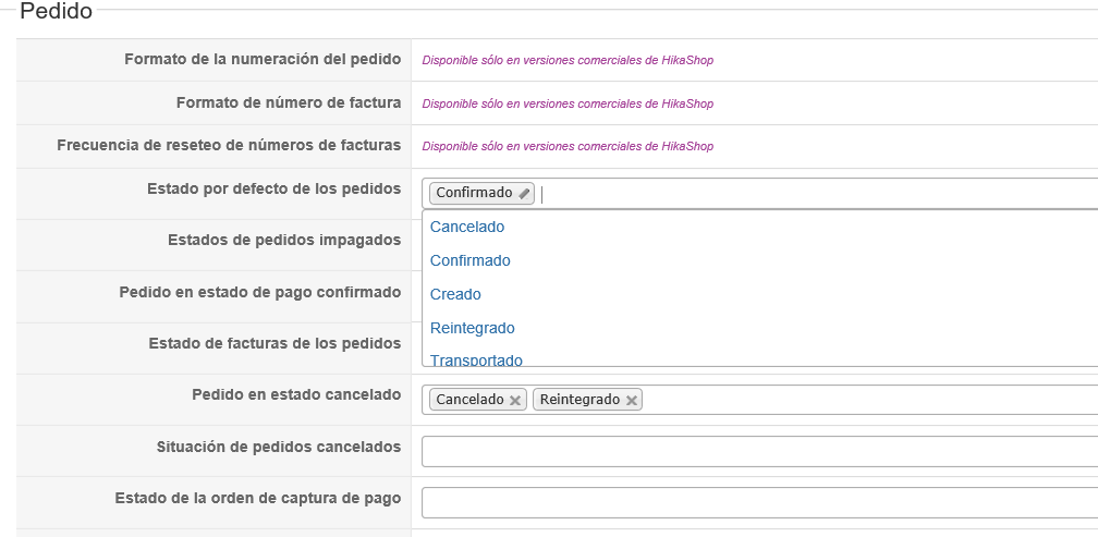

  • Posts: 75
9 years 10 months ago #252126
Hi Jerome.
Thanks for your answer.
When I go to select the order status, I can only select what you see in the image.
Regards.

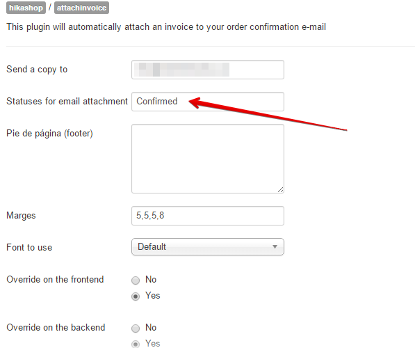

  • Posts: 86079
  • Thank you received: 14186
9 years 10 months ago #252127
It's in the setting "statuses for email attachment" that you need to enter "confirmed".
You don't need to change the setting in the HikaShop configuration.

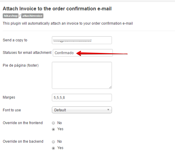

  • Posts: 75
9 years 10 months ago #252237
Hi Nicolas.
I know that it`s in the setting "statuses for email attachment" "confirmed".
But don´t send invoices.
  • Posts: 86079
9 years 10 months ago #252239
You need to write "confirmed" in it, not "Confirmed". That's why it still doesn't work. Please do that.
Other than that, make sure that the plugin is enabled and its access set to "public".
