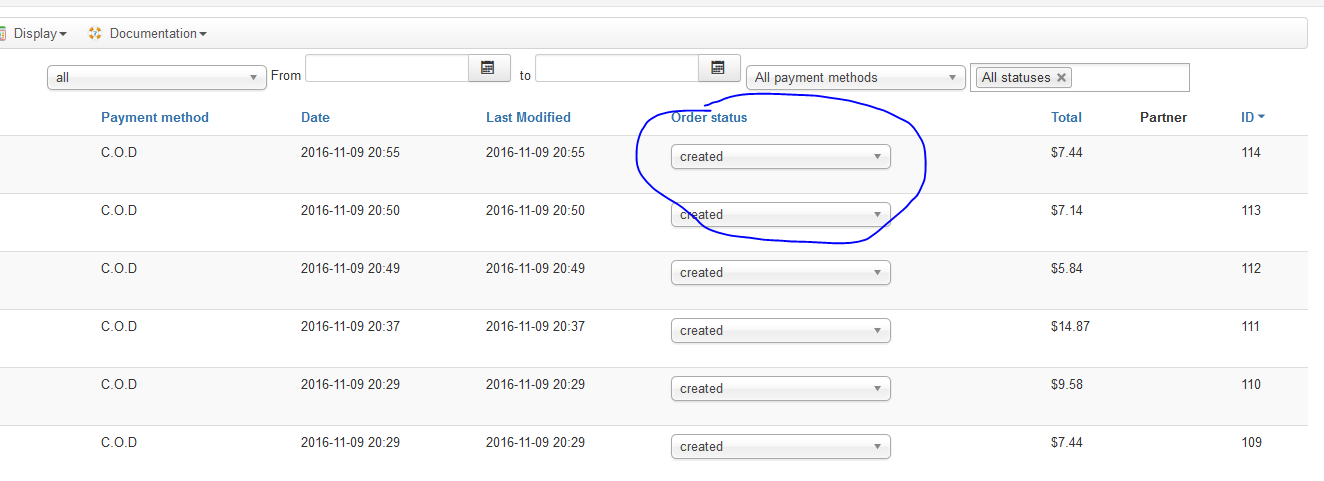

In the back end at order status i try to change the order status to confirm and i get this error message. please help me. thanks

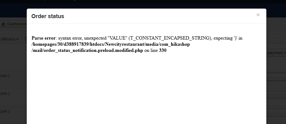

Parse error: syntax error, unexpected ''VALUE'' (T_CONSTANT_ENCAPSED_STRING), expecting ')' in /homepages/30/d388917839/htdocs/Newcityrestaurant/media/com_hikashop/mail/order_status_notification.preload.modified.php on line 330
9 years 9 months ago #254887
You have customized (modified) your email and in your modified content, you have a PHP error.
Please fix your code or remove your modified file in order to let HikaShop use the default one.

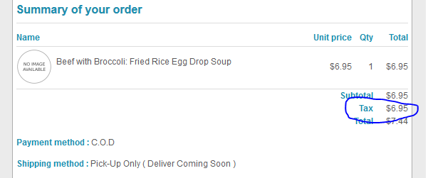

I put it back original file then i can confirm. but i have this issue please see the picture. on the tax area i want it only show tax. thank you

I using the 2.6.4 . So I want the order show only tax only instead total-without-tax. Thanks

If you use the default email files, does it display properly (without errors) ?
And in that case, what is the exact problem with the taxes ? What is displayed, and what would you prefer ?
You said that you changed something in the override of the email preload. What precise change did you made ?
