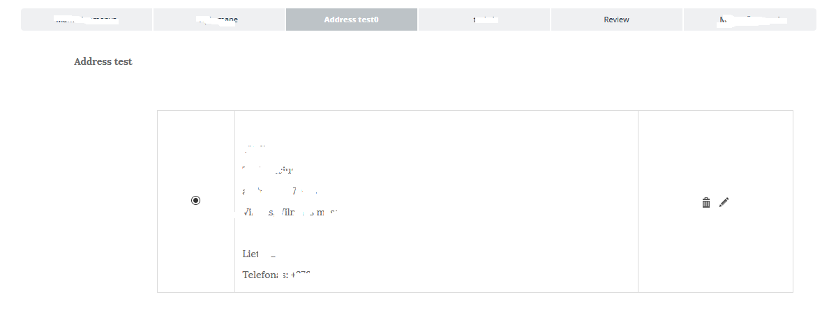

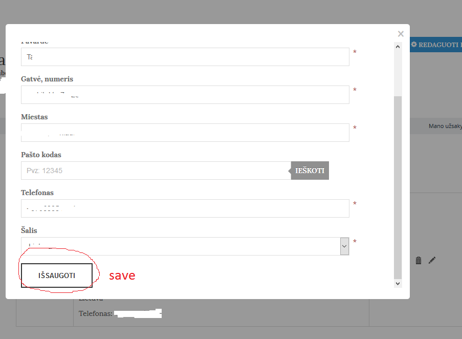

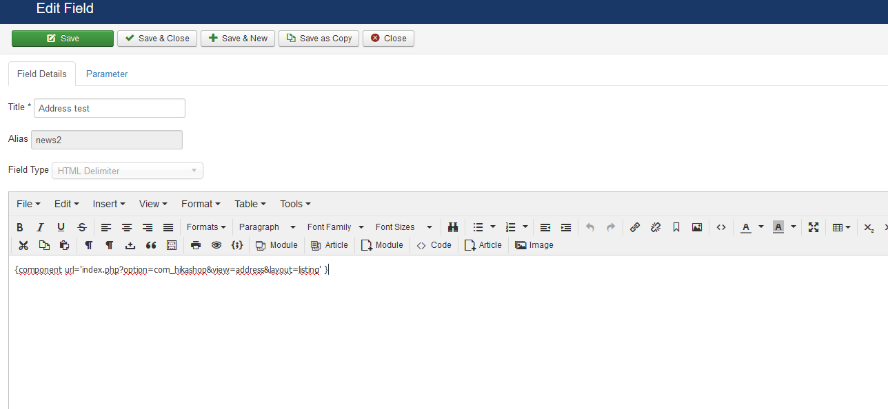

9 years 10 months ago - 9 years 10 months ago #257603 by kyratn
1. Awesome. Thanks
2. To have address addition tab I did this. I have installed such plugin: extensions.joomla.org/extension/include-component
In easy-profile I have created new group and named it address test0, then I have created user field named address test, type html delimeter and assigned it to that group. Added such tag inside that user field {component url='index.php?option=com_hikashop&view=address&layout=listing' }
Now it shows address edition page inside tab. All should work I think but then you press edit address, pop-up is displayed and then save it redirects to home page and shows address edition between all modules. Same as there would be no menu item for it...And url is like this: /component/hikashop/address
Maybe there is a way to change where it redirects after you press save button...
I also have attached some screenshots.
Thank you

9 years 10 months ago #257612 by nicolas
You would have to change the line:
Code:
echo '<html><head><script type="text/javascript">window.parent.location.href=\''.$url.'\';</script></head><body></body></html>';
to:
Code:
echo '<html><head><script type="text/javascript">window.parent.location.href=\'XXX\';</script></head><body></body></html>';
where XXX is the URL of the profile in the file components/com_hikashop/controllers/address.php
The following user(s) said Thank You: kyratn
