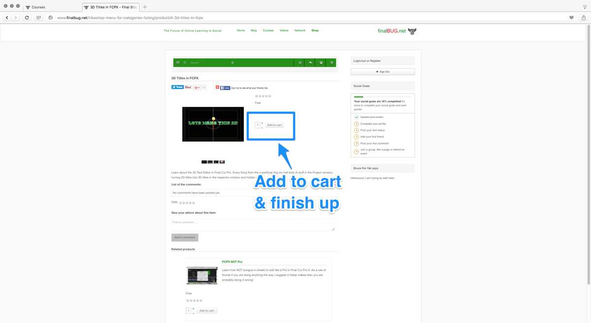

a) I purchase a product by pressing the add to cart button, filling in details and press Finish.

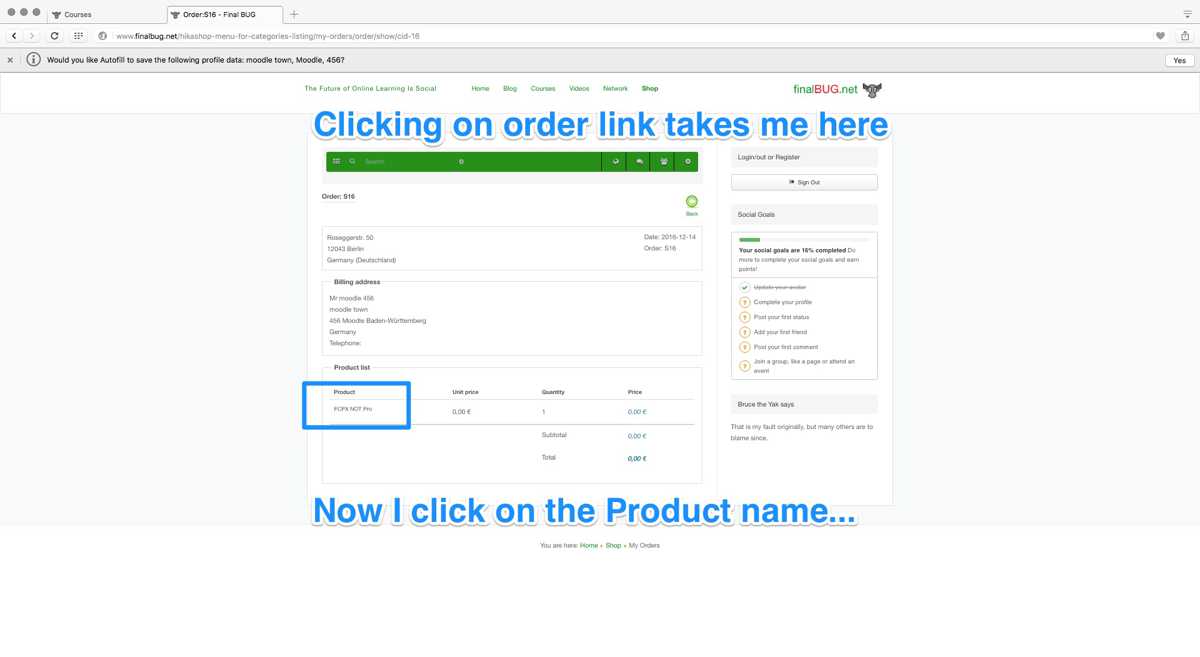

b) I am taken to a page where my order is confirmed and I have an order number. Eg order No. W19
c) Clicking the order number takes me to a more detailed invoice for my order.

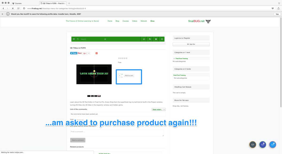

d) Clicking the name of the product I bought on the invoice brings me to a page where I can buy the product again!
This last step has me confused.

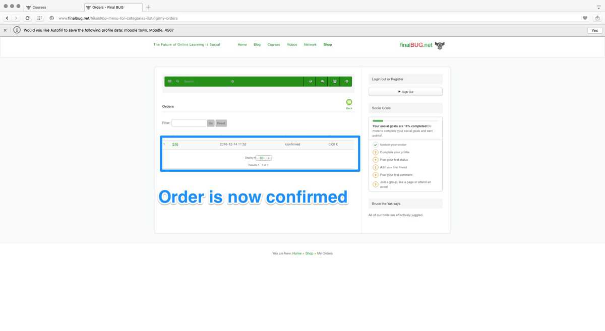

The status of your order No. W19 has been changed to confirmed.
www.finalbug.net/index.php?option=com_hi...=order&task=show&cid []=19&Itemid=2117

1. That's normal. Suppose you buy a cup on amazon. The link on the order will allow you to look at the product again so that you can buy another cup. That way you can buy several cups for your tea set if you liked the first one.
You say
I would be taken to the product
but that's what it does. It takes you to the product page of the product.

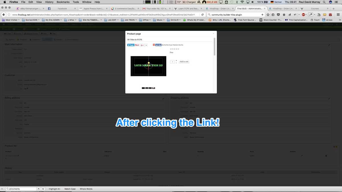

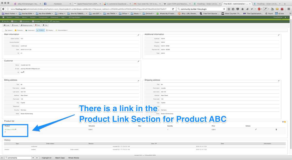

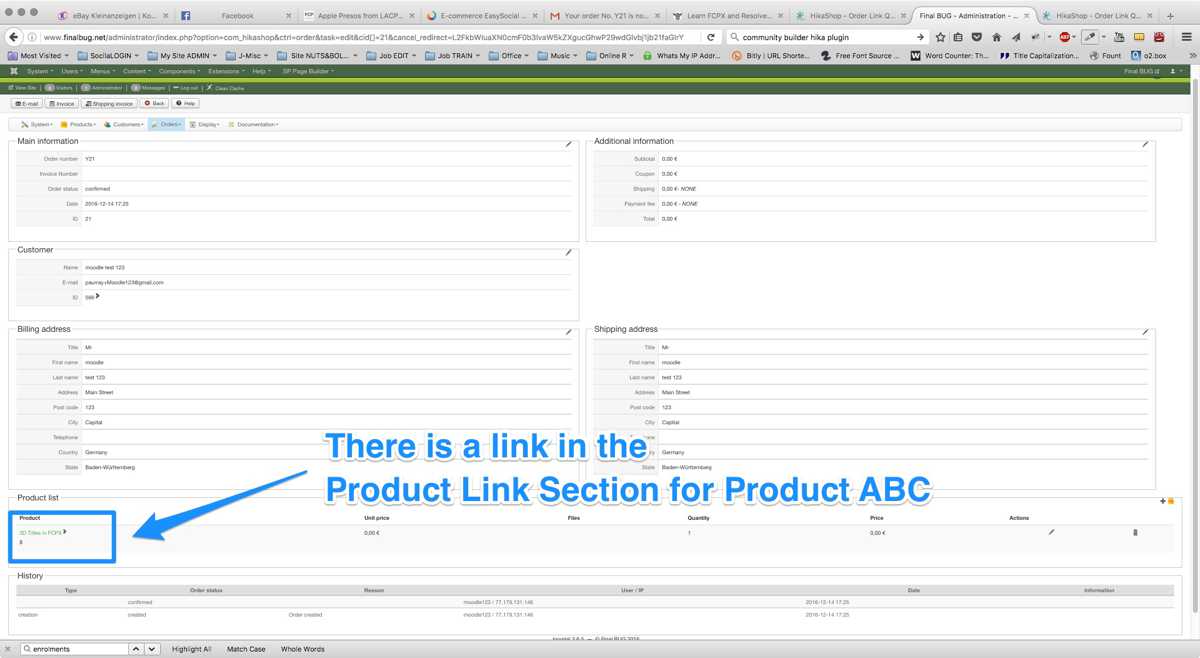

Do you see the download link in order details page in the backend ?
Going to product ABC in the orders section I see this:
When I click on the link and am logged in (front end as well) I see this:

1. If you want to sell videos with HikaShop, then just add the videos in the "Files" area of your HikaShop products.
They will be automatically available for the customers to download with a link in the email notification, in the order details page and in the download manager that you can activate with the option "Enable customer download area" of HikaShop.
If you're talking about giving access to moodle content after the purchase of a product in HikaShop, that is done by the moodle integration with HikaShop and that integration doesn't have any system to add links to the orders in HikaShop (although HikaShop provide triggers for third party developers to add such content if necessary).
3. As I said in point 1 above, the moodle integration doesn't add any links to the HikaShop order. But if it was implementing the triggers HikaShop offers for that, it would be possible. The trigger to implement in order to do that is: onAfterOrderProductsListingDisplay. You can find some information about it here:
www.hikashop.com/support/documentation/6...oductsListingDisplay
So you might want to talk with the Joomdle developers about adding such trigger in their integration with HikaShop so that it could do that. I'm sure many users of Joomdle and HikaShop would be interested.
4. The orders listing integrations take you to the order details page in HikaShop where you'll find a listing of the products of the order with links to the product page of the product, not to joomdle. So I don't think it would help.

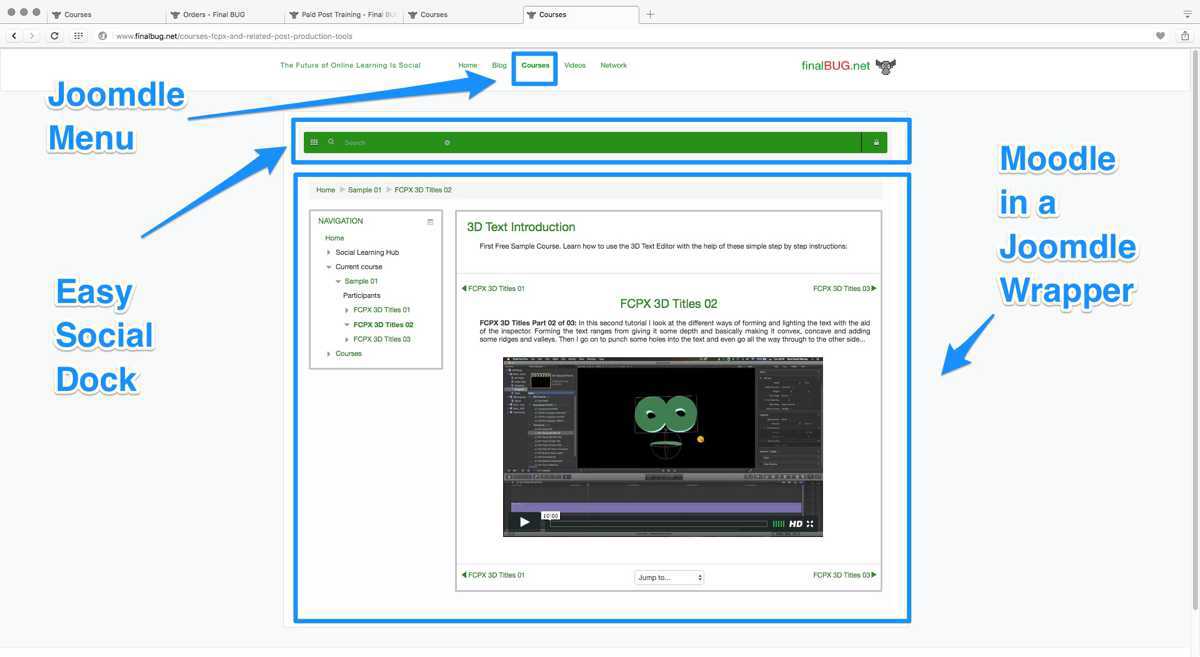

Yes this is what I am talking about. And I am going to do the following:
- Modify the Hika mails so there is at the very least a link pointing to the Moodle Courses.
- Have Joomdle send out a link to the purchased course (got this working on Friday)
- Use something like ReReplacer to search for that text in the 3rd screen shot in this thread!
www.regularlabs.com/extensions/rereplacer
Obviously I need the paid version to make custom course names on the bills rather than Your order No. B3Q7 etc
ReReplacer would look for e.g. “3D Text in FCPX” or “Edit in Resolve 11” on certain pages.
And strip out the link that goes to the Hika Shop to purchase (in my case) AGAIN already purchased course…
… with a link that goes to the course in Moodle!
et voilà
