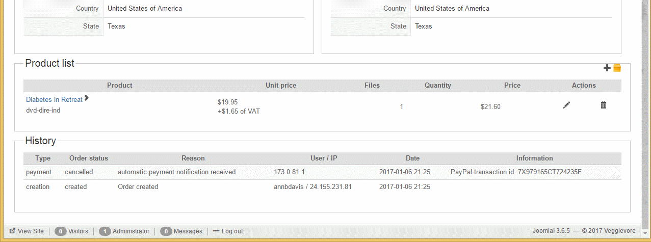

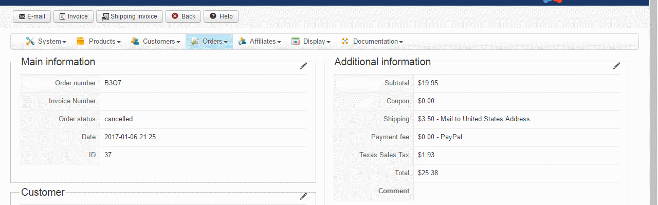

I just looked at an order and found that there is a section called Product List of the back-end order information that is for some reason displaying a calculation that includes VAT which is not relevant to us. I see that the actual order did properly charge Texas Sales Tax so this information in the Product list section is not relevant. But, it did confuse me for awhile.
How can i change this? I am attaching an image of the bottom with the VAT calculation and the top which properly calculates the Texas Sales Tax.

It is important to display the tax for each product in the order so that you know the repartition of the tax amounts as different products can be taxed with a different percentage.
If you don't want that, then edit the file "show_products" of the view "order" for your backend template via the menu Display>Views and change the line:
<td class="hikashop_order_item_total_price_value"><?php echo $this->currencyHelper->format($product->order_product_total_price, $this->order->order_currency_id);?></td>
to:
<td class="hikashop_order_item_total_price_value"><?php echo $this->currencyHelper->format($product->order_product_price*$product->order_product_quantity, $this->order->order_currency_id);?></td>

I am actually happy to have the tax calculated there. I was just writing because it was calculating VAT instead of Texas Sales Tax.
Can you tell me why it might have been calculating VAT in the Product List section of the back-end order information?
In the Additional information section it is properly displaying Texas Sales Tax.

However, there also has to be something else going on besides just a language translation. I could get rid of the language string easily enough but the amount that is being calculated and displayed is also wrong. It appears to possibly be based on a VAT percentage?
If you look at the two images I submitted originally you can see that the top of the page has the correct amount. The bottom section where it says VAT is displaying the wrong amount.
In "Additional information" the correct Texas Sales Tax is displayed which is $1.93
In "Product list" a wrong amount is displayed. What shows is the following: +1.65 of VAT

The difference you see in the amount is probably the shipping fee taxes. Set the tax category to none in your shipping method if you don't want it to be taxed and you should then have the order total tax amount equal to the sum of the tax amounts of the products.
Since you don't have any payment fee, setting the tax category in the payment method won't change anything.

Ok. I finally get what is going on here. Sorry to be so slow to reply. It has not been a serious enough problem to get my attention.
But, what is happening is not really a problem so I am not going to worry about it.
I do have to collect taxes on shipping in Texas and that is reflected properly in the Additional Information area.
The Products area of the Order is calculating the tax on the product alone and not including the tax on the shipping. That is why the numbers are different. And, nobody but me sees that section so I think I can just leave it alone.
