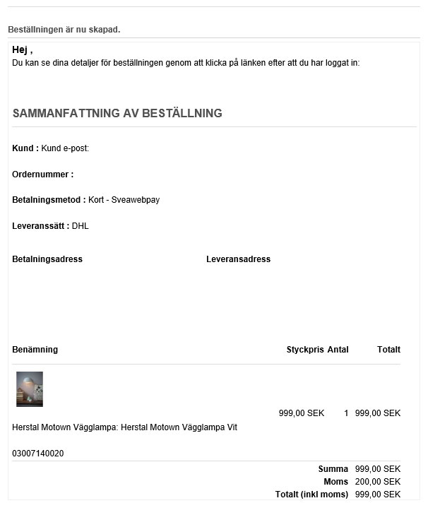

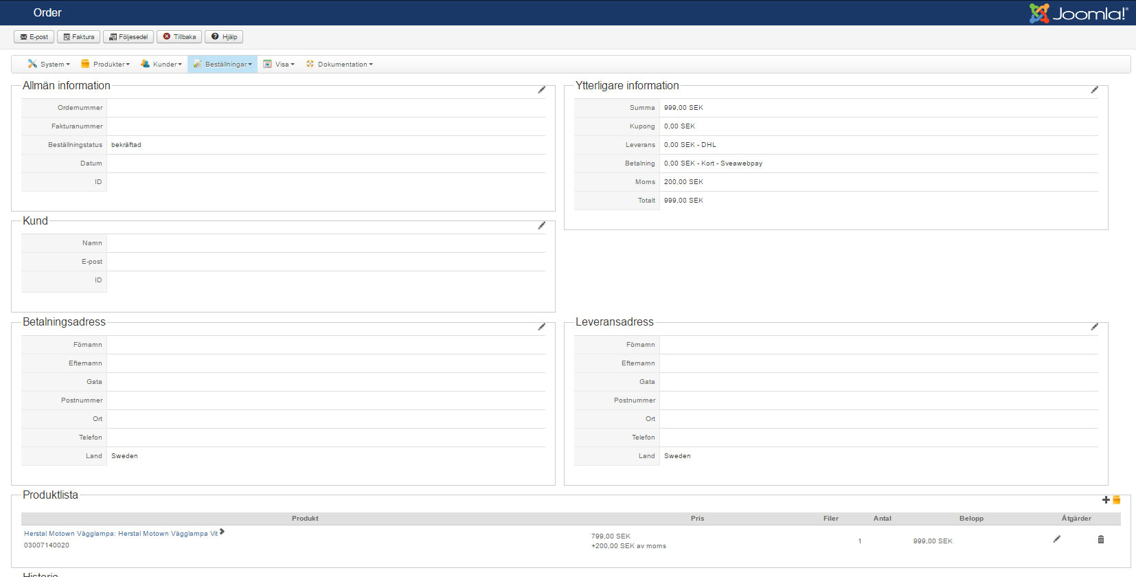

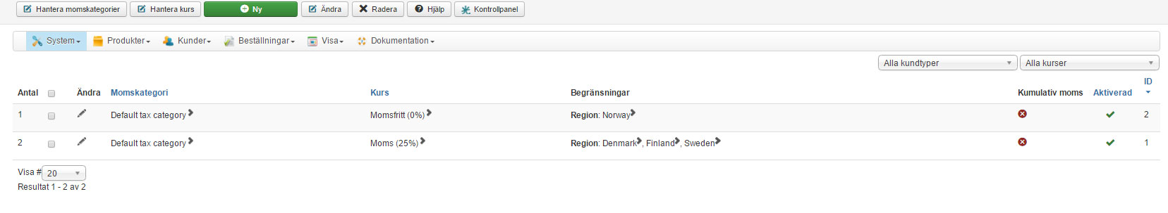

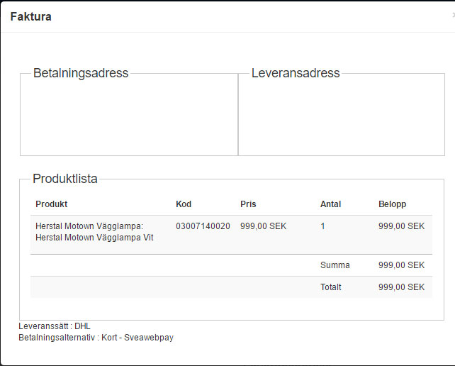

  • Posts: 29
9 years 7 months ago #259082
Accompany pictures on order, e-mail, tax rates and the code for the invoice and the invoice

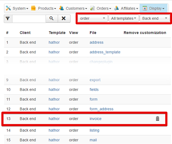

9 years 7 months ago #259118
I'm quite surprised by your screenshots, one question do you have some override view and especially on your order view ?
To check this point, go to Components => HikaShop => Configuration, on Display dropdown select Views.
Then, use the three dropdown filters with : Order/Your backend template/Back end.
See, the view number 13, called invoice, the little trash icon means that there some custom (or an override) on the invoice view.
If you have this, save it on your side, and try to delete it by clicking on the trash icon.
And if, that solve your issue that means that your override is the roots issue.
Awaiting news from you.

  • Posts: 86079
  • Thank you received: 14186
9 years 7 months ago #259157
The tax data is in the order details page based on your screenshots. So if it's not in the invoice I can only think that the code of the invoice has been changed.
