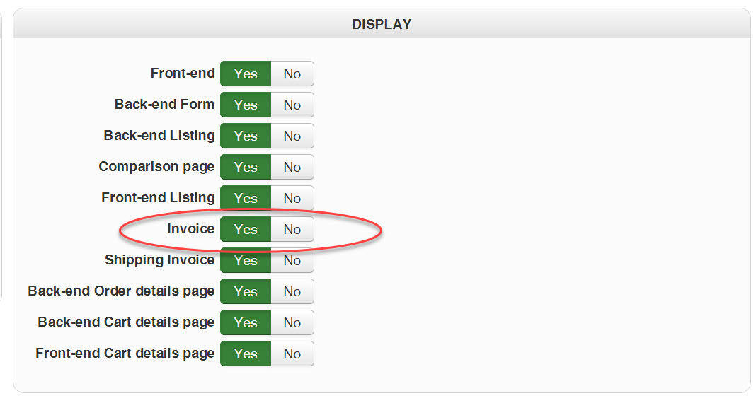

9 years 6 months ago #262046
With Hika 3.0 several options are DISABLED by default..... please look at the settings of each custom field. You now have options to include or exclude in DISPALY, in MAIL and in CART. On of the option under DISPALY is to include it in the invoice....

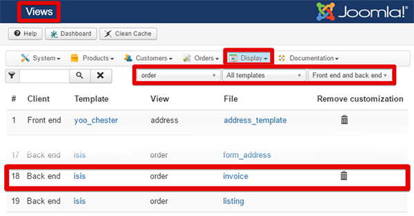

9 years 6 months ago #262545
I have a look on your back end, and I see that you have some override view on the invoice view, maybe it's linked to your issue.
Can you save your custom view on your side, delete it by clicking on little trash icon and process some tests to see if that solve your issue.
Awaiting news from you.
Last edit: 9 years 6 months ago by Philip.
  • Posts: 637
  • Thank you received: 26
9 years 6 months ago #262621
Done! And unfortunately the invoices are still without custom fields.
Kind regards,
Lumiga

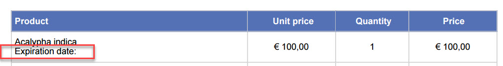

I have put the code into the invoice.php of the PDF invoice plugin.
But I can't get it work.
See my code:

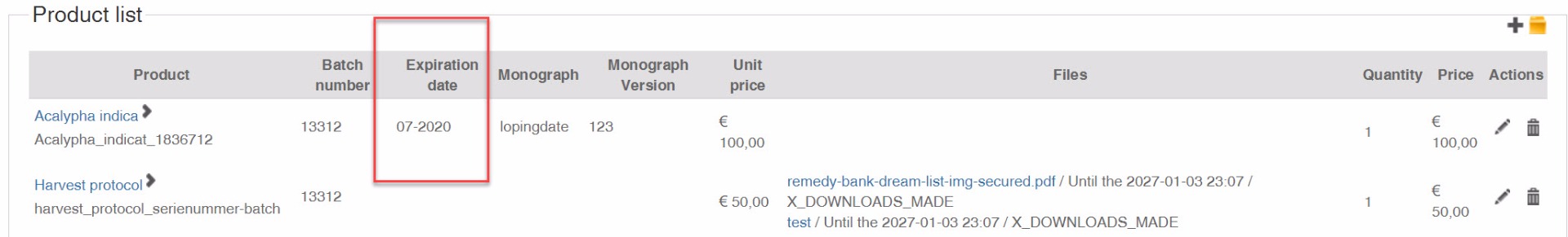

As you can see I have a order with custom code Expiration date:

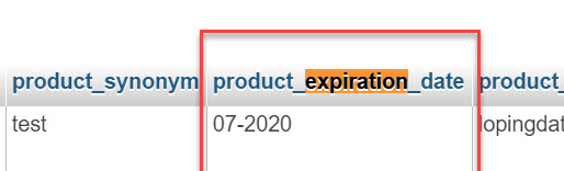

And I use the right column name:
And the code is at the right place, because when I use only the code:
echo '<br/>Expiration date: '.$product->product_expiration_date;
It shows the content on the right place. But there is no input from the database over there.
I hope you can tell me what's going wrong.
