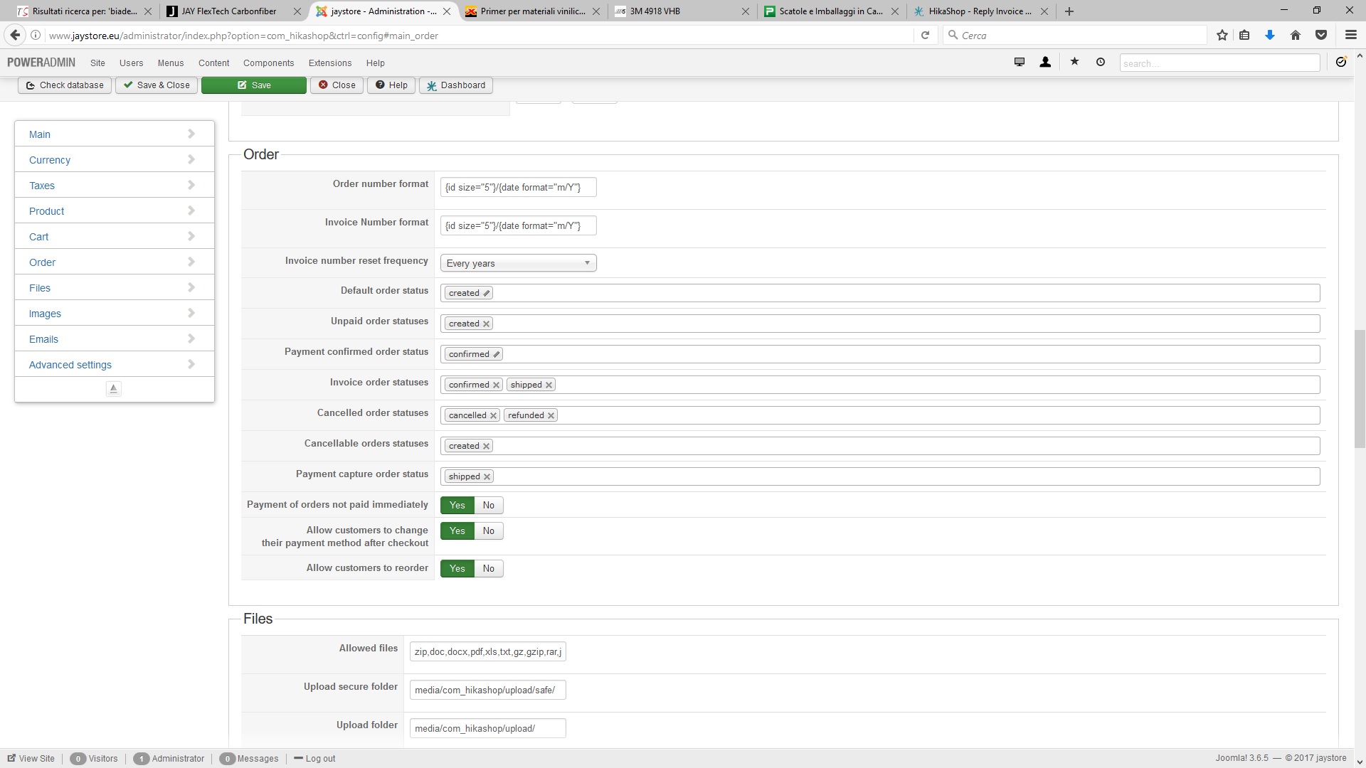

9 years 4 months ago #265901
Please check configuration in attachment

9 years 4 months ago #265907
As far as I can see it looks good.
Are you sure that you're looking at the invoice number and not the order number ?
Because only the invoice number is reset with that setting. The order number keeps on incrementing no matter what.
Also, the invoice number is only generated when the order is confirmed. If the order stays created, or if the payment plugin you're using doesn't properly change the status of the order via the standard functions of HikaShop it's possible that the invoice number is not generated and you're actually looking at the invoice number.
On our end I did some tests just to make sure and it works properly.
Could you do a screenshot of all the details of an order with the problem when you edit it via the backend orders manager ?

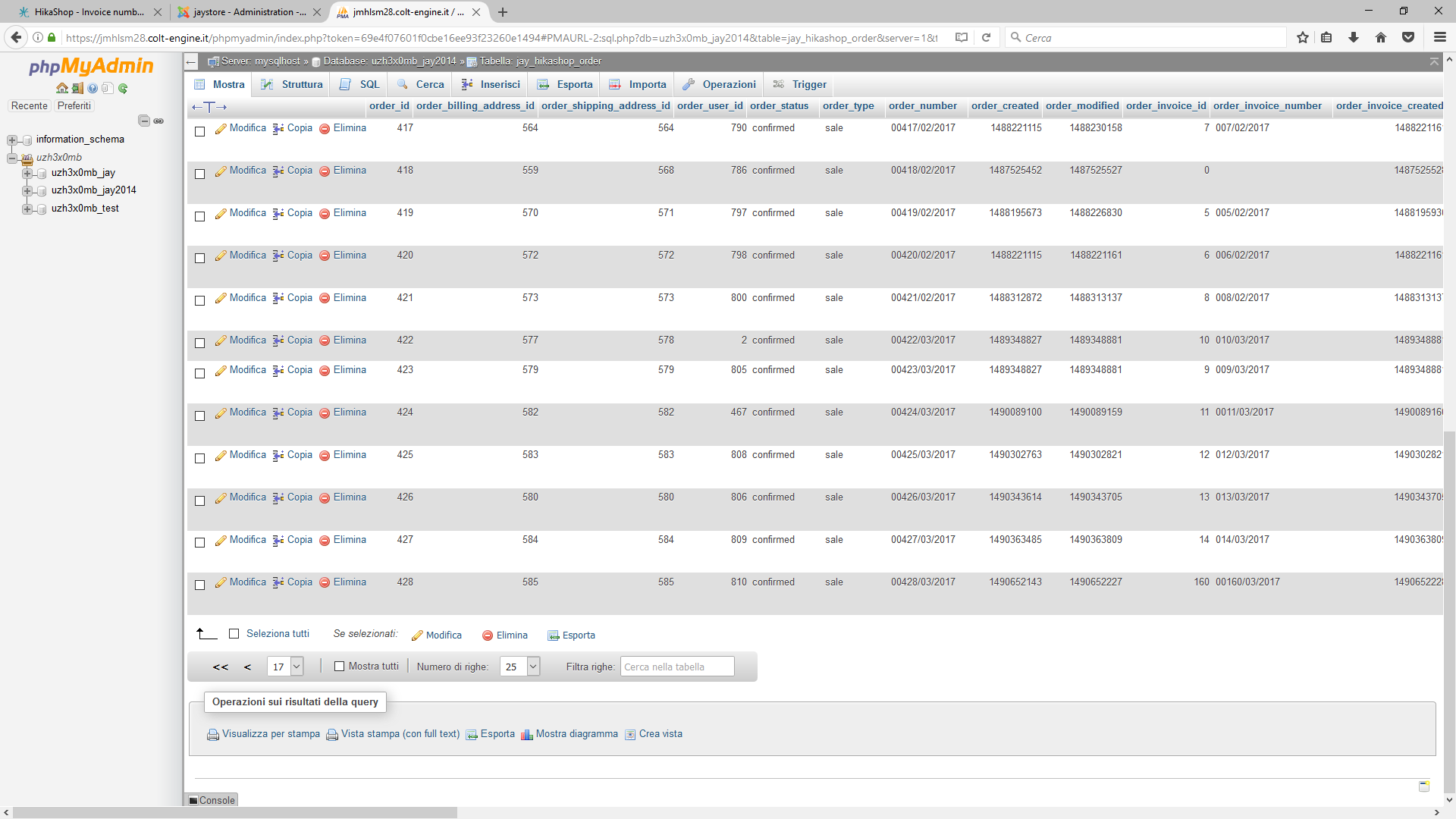

  • Posts: 8
9 years 4 months ago #265968
Last order, this is data base data, the last order is 00160/3/2017 and the previous was updated to 014/3/2017
