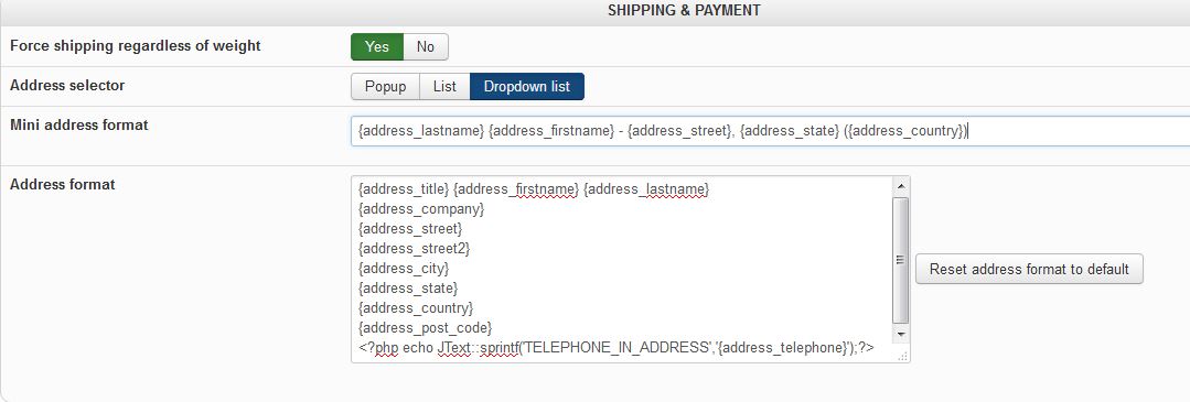

In the HikaShop configuration, you'll find an option "address format" under the "checkout" tab.
Make sure that the tag for the custom address field is in there like the others and in the position you want it and save the configuration.

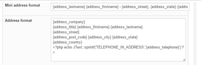

I have the address format set as I need it but it looks like this is being ignored by the invoice template, which appears to be using the default setting.
My address format configuration ...
Hikashop default address format ( from the online documentation )
Address as it appears on Invoices (company field not used)
{address_title} {address_firstname} {address_lastname}
{address_street}
{address_post_code}{address_city}{address_state}
{address_country}
telephone:
Main issue is that address_street2 is missing but also post_code is in the wrong place ( for UK addresses ).

It works just fine on my end.
Can you check in the menu Display>Views that you have the "address_template" view file overridden with the correct data for both your frontend and your backend and if note, make the modification there ?
And if you disable the PDF invoice plugin, do you get the correct format in the invoice ?

The front end template was correct but the back end template wasn't, are these both changed when you edit the configuration?
Anyway I have edited the back end template manually and it is working as expected now.
