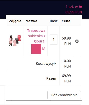

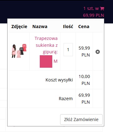

Hi.
When I use the delete button for dropdown cart the first time the product is removed immediately from a cart and cart is empty, but the second time when I add product to the cart and try detete it, cart does not reload.
