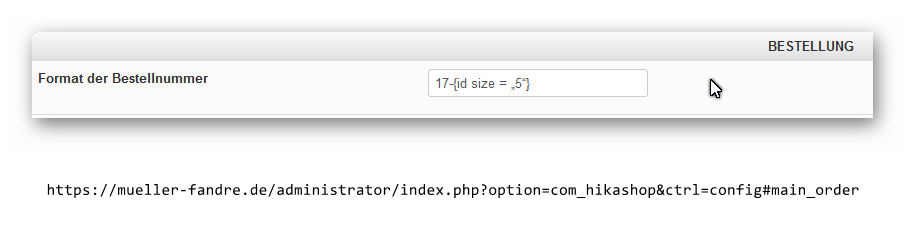

How can I change the Order Number?
This {id size="5"} doe not work. I replaced the "automatic_code " with this string The result is the same (id size="5").
How can I change it? What is the right syntax?

If you were using {id size="5"} it would work. However, on your screenshot, there is a space before the =, after the =, and the double quotes are not the standard double quote characters but some other character of UTF-8.
If you use exactly {id size="5"}, you'll see that it will work.

that worked. Maybe you could change the code in the manual to a code which could be copied, or add the information to have no blanks in the code.
thx
