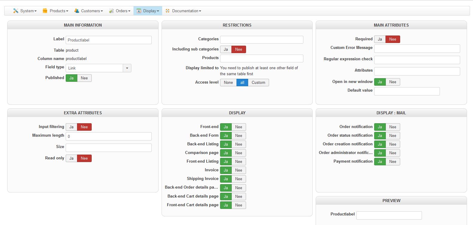

  • Posts: 6
9 years 2 months ago #273049
Here is the screenshot.
Just to be sure I turned eveything on.
Last edit: 9 years 2 months ago by vectoronline.
  • Posts: 6
9 years 2 months ago #273066
I just found it! It works for the main product without variants.
And it does NOT work for variants! I checked the database and the custom field of all variants are empty.
So the question now is: how can I display a custom field of a variant product in the mails?
