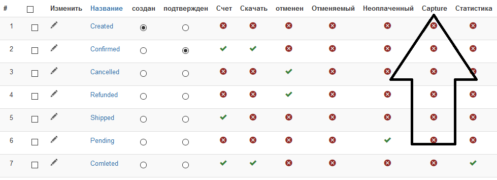

2. Why there is no current order status at "detailed order view" (order / show.php)? Why there is no history of changing order statuses on that page?

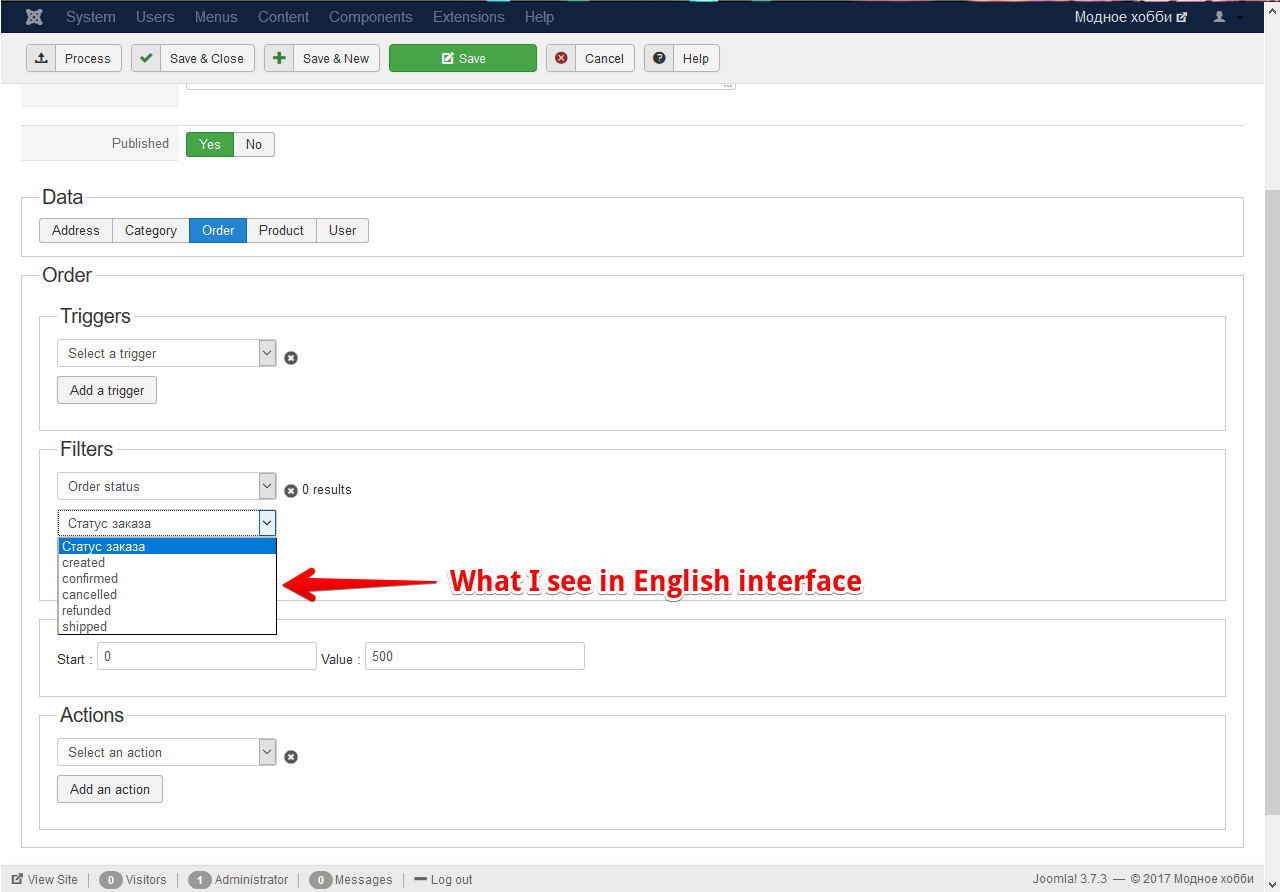

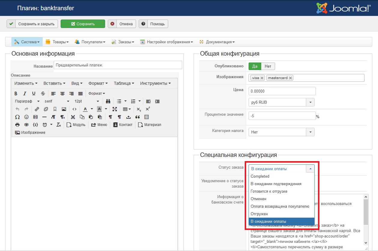

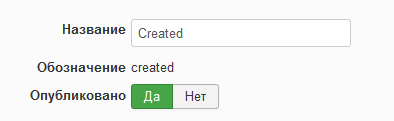

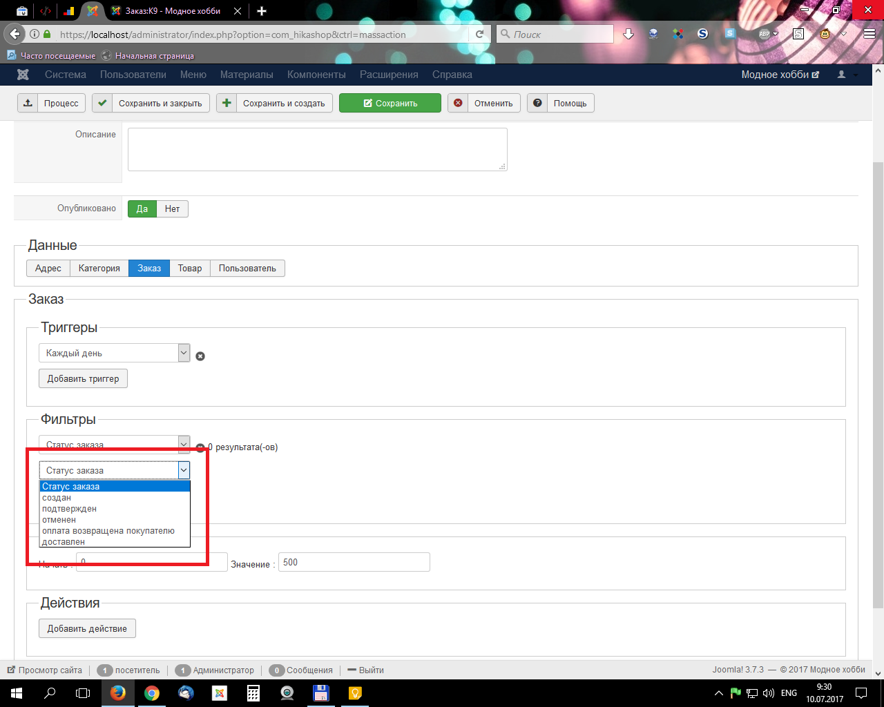

5. I have overriden language constants with the order status names. Now, for example, in the payment methods in the dropdown list, I see new names. But in mass actions old (not overriden) names are used therefore, it introduces confusion (this can be seen in three screenshots below). Is it possible to fix this?

1. That setting is not used for now. That's why it says N/A which means "not available"

5. It's normal. In the mass actions we use the real values that are stored in the database. If you use an action "display the values" with the "order_status" column you'll also see the real value stored in the database.
And same if you want to update the values in the column with an action, you need to enter the order status in english because that's always that value with is stored.
That's done on purpose and there is no way to change it.

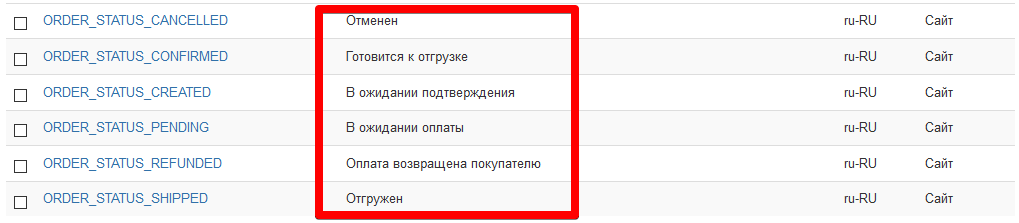

2, 3. Yes, I'm talking about the frontend because I'm used to seeing the order status and the history of its change in other shopping cart. Which code must I use to get id and current order status in order / show.php?
4. It's set to "created" but doesn't work when a buyer chooses a payment method whose configuration of order status is set to Pending. This is what I'm trying to explain. If on checkout page a buyer chooses the payment method whose configuration of order status is set to Pending then order is immediately assigned a status Pending and that is why it doesn't work. So is it possible to add more items from the list of order statuses or to add an option "Any" which means that the cart will be cleaned at any status of the placed order?

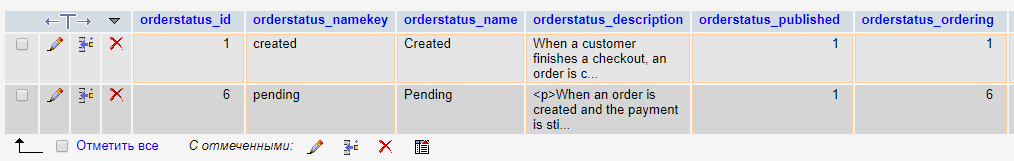

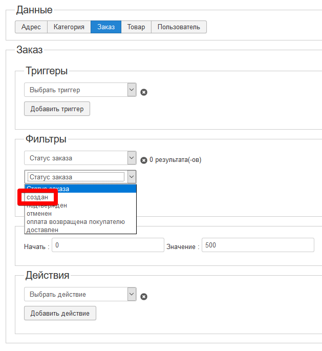

5. But this is not so, take a look at the screenshots, them show that for the Created status the value in database is "created" but in the list of order statuses in mass actions I see the values translated into my language. So I ask, if the order status values are displayed in my language, then why not use overridden values in my language?

5. In order to simplify the coding on our end, we've reused the same code which controls the display of the order statuses dropdown selectors elsewhere. That dropdown supports the translation of the order statuses. That's why it's like that. But as I said, all the code of the mass actions system (besides that dropdown which comes from another part of HikaShop) uses the values from the database.

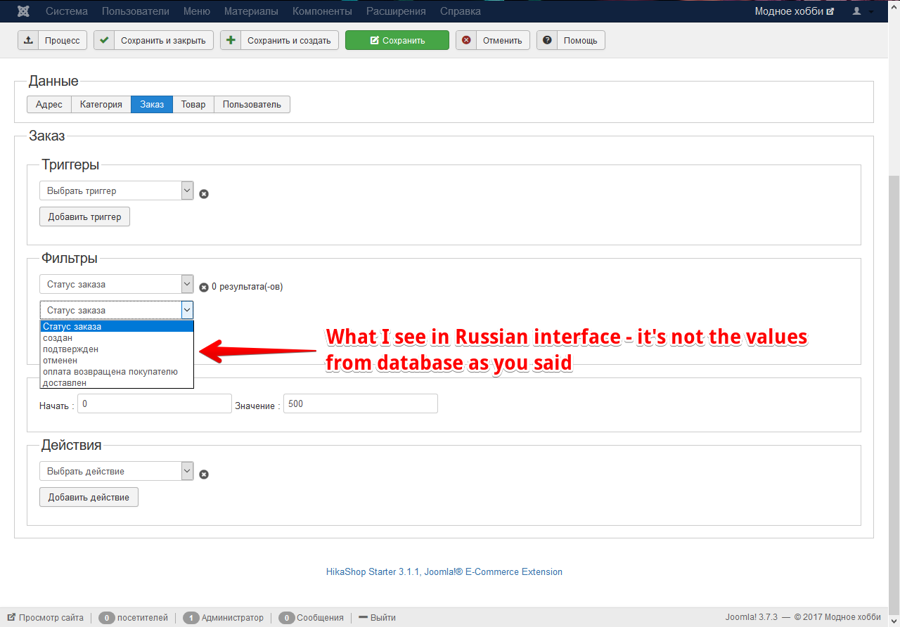

5. You said that the code of the mass actions system uses the values from the database and I see that it is so if interface language is English but if if interface language is Russian I see translated values and not the values from the database. Please take a look at the second and third screenshots. That's why I'm asking - if you still display the translated values from the language file and not the values from the database in the mass actions system, why not display overridden values for current language? I have overridden some values of order statuses in Russian language, but in mass actions I still see the initial values from the Russian language file.

5. No, I specifically said that the mass actions system uses an external dropdown for the order statuses and that this dropdown supports the display of the statuses in the language, but not the rest of the mass action system.
So it's normal that it is like this.

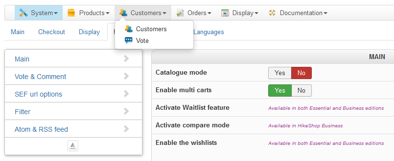

4. You're right! It's the "enable multicart" setting caused that "issue".
But I don't see the menu Customers>Carts on the backend (there is screenshot below), have I truncate hikashop_cart and hikashop_cart_product tables?

4. Ah yes, that's a feature of the commercial editions of HikaShop. So you can truncate the tables yes.
