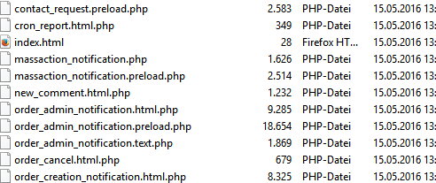

  • Posts: 7
8 years 11 months ago #274024
Hi!
Unfortunately, I can not find the / media / com file hikashop / mail / order creation notification.reload.modified.php. Please see Appendix.
  • Posts: 7
8 years 11 months ago #274030
Sorry, I found this file. Somehow overlooked. Many thanks for the help!
