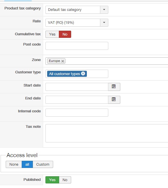

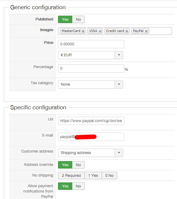

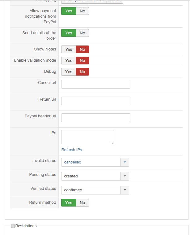

  • Posts: 157
8 years 10 months ago #275748
There is only pay pal
payment. I attached screenshots of configurations. Please let me know if you need something else.
Thank you!
  • Posts: 85834
  • Thank you received: 14092
8 years 10 months ago #275751
Then first, download the plugin there, install it and activate the "new IPN" setting of the payment method:
www.hikashop.com/forum/payment-methods/8...sactions.html#273747
That might help.
If it still doesn't work after that, then please follow the instructions there and activate the debug setting of the payment method, wait for an order with the issue (or make one) and provide the payment log from the HikaShop configuration:
www.hikashop.com/support/documentation/i...or.html#notification
